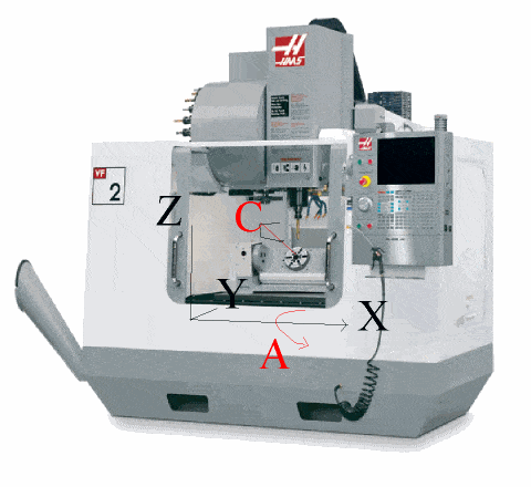

This machine has 3 linear axes (x,y,z), direct coordinate system
It has 2 rotary axes:
A turns about the x (called 'tilt')
C is carried on the A axis (called 'rotary')
See picture of an example of such machine.

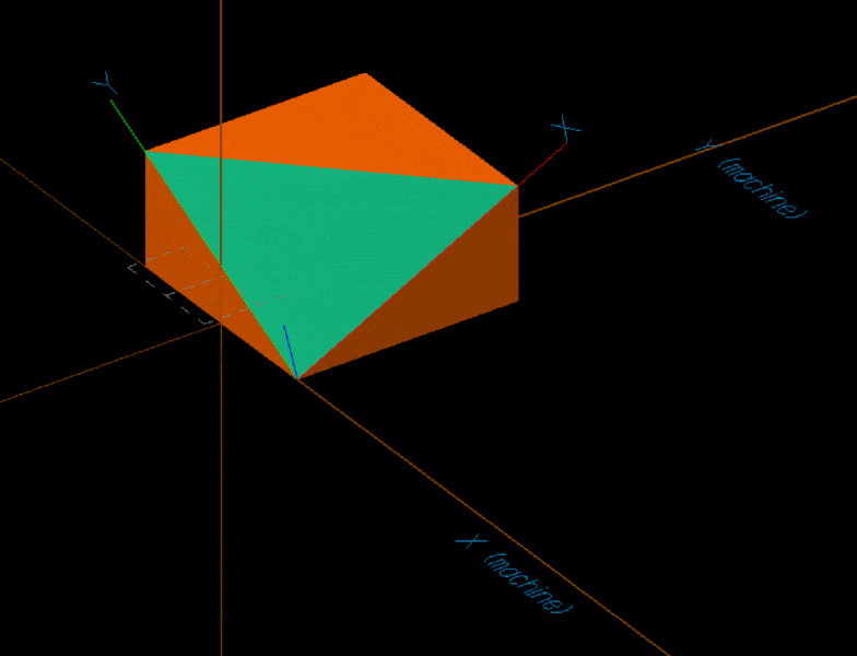

I want to machine a feature (ex: drill a hole) on a randomly oriented face
My CAD software gives me the unit matrix of the 'local' coordinate system:
x1 x2 x3
y1 y2 y3
z1 z2 z3
See the 2nd picture:
- blue face is the face (local xy plane) that has to be positionned parallel to the machine (brown lines) XY plane
-The machine only has 2 rotations so the best it can do is to make the local coordinate system Z axis parallel to the machine's Z axis (spindle)
Then I need to add the 3rd rotation by rotating (or mapping) the local coordinates around Z to express them in the machine's XYZ.
I am able to extract the 'A' value:
A=atan2( sqrt(z1*z1+ z2*z2),z3)
In the example picture, the cube is 2x2x1
In this particular case:
A = 35.264
C= 135
That brings the blue face (or the local z axis) parallel to the machine's Z axis.
But the part is rotated 180 degrees around z.
I can easily rotate the coordinates with a rotation matrix. This is the 3rd angle that is not physically there (like an Euler type machine) but can be implemented via matrices.
How do I extract the 'C' move?
How do I extract the 3rd angle?
Thank you,
Paul
