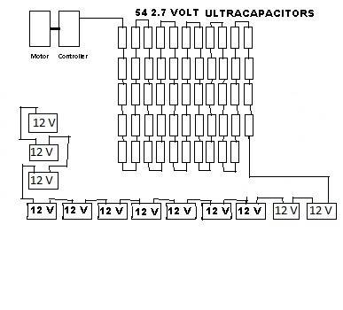

I have 54 Maxwell 2.7 volt 3000 farad ultracapacitors and would like to know if they can be placed in series with 12 12 volt lead acid deepcycle 200 ah batteries. all in series.
would it work? why yes or why not?
this is a circuit to operate a electric vehicle.

I assume you understand what a capacitor is and does? But then again, why would I assume that? The total series capacitance of 54 * 3000F capacitors would be:
3000F/54 = 55.5F
The rated voltage of your series would be:
2.7V * 54 = 145.8V
Since most 12V lead-acid batteries actually have a nominal voltage of 14.4V when fully charged, you would exceed the voltage rating of the capacitor string by:
14.4V * 12 = 172.8V ==> 172.8V - 145.8 = 27V
Next, DC current flow through series capacitors is limited by:
I = E/R * e^(-t/RC)
Perhaps you meant to use the capacitor string in parallel with the batteries? I am not sure what you are attempting to achieve with the capacitors. Anyway, you might consider do some reading:

If you plan on wiring all those in series do you have a way to guarantee that all capacitors see the same voltage instead of some being overvoltaged?
maxwell suggests I use a 54 ohm resister as a bleeder in the vent of overcharge.
the raises a question of what kind of 54 ohm resistor ? 54 ohms and ?. plus where should it be wired in? parallel to a bus bar? or directloy inbetween the + and - of two caps.
You need a resistor across each capacitor if they are all wired in series.
Ultracaps have a much lower internal resistance than chemical batteries. They can increase the efficiency of a battery powered system. A common application is to have the ultracaps as electrically close to the load (control electronics) as possible. The battery then becomes just an energy source, and not an energy source and a power source. The ultracaps can provide short bursts of very high current that would otherwise not be possible because of the internal battery resistance and wiring.
michaeljaycla, your circuit shows the series ultracaps connected in series with the battery bank. That will not work. The series ultracaps should be in parrallel with the battery bank.

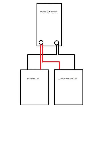

I thought about how much power is really there in the capacitors.
Tecate has a capacitor sizing tool where you can size up how many ucaps you would need to supply a contast current or constant power.
My motor controller will draw 600 amps under full power, that would be wide open acceleration.
That won't be drawing that much current very often at all.
so with that said, the tool indicated that 60 capacitors would be able to deliver 600 amps for 11 seconds and the ucaps will still have 30 volts left.
600 amps will only be the launch of the vehicle when i want that much power.

This circuit is going to be in an electric vehicle. The motor controller will be a soliton junior that can deliver 600 DC amps on a constant basis.
the ultracapacitors will be in parallel with the batteries at this point. That seems to be the least expensive way to do these tests at this point.

the capacitors will not be whiched in and out of this circuit. they will remain in parallel the entire time.
the only time there will be a draw of more than 250 amps from the cap and batt banks is under acceleration. the caps will deliver the current under demand and the batts should start filling the caps as the caps send their current to the motor controller.
I have inquired what the amperage draw would be on the batts as this happens but because of the amount of varibles involved, it cannot be calculated.
A 600 amp shunt will be placed on the positive cable going to the motor controller from the batt bank. the same for the cap bank. these measurements will decide the argument once and for all.
the test vehicle is a 1994 chevy s-10 that weights 4500 pounds. the batteries are brand new, 24 235 amp hour deka pro master series 6 volt batteries. the next test vehicle is a 1996 gmc jimmy.
At least you've changed from series connection to parallel (title and OP). ;-). That makes some sense.
Maxwell says in an email that series can be done but with some extensive control circuits to be sure the caps never try to send current back to the batteries and flow backwards.
we'll try parallel for now.
Unless you are trying to use your capacitors at excessive voltages there is absolutely no point in using series connection. It just means that the resulting net capacity is significantly less.
A lot of potential problems are hidden within that magic word "control". What could work at 'signal levels' is a lot more difficult to implement with 100s of A.

In general, I agree with the other posters, Michaeljaycla is in danger of making a very high energy event by accident and hurting himself or others. If it is a sudden discharge, or equalization, then radio enthusiasts all over the world may hear it as a single crackle in the background static.
I do not believe ultracapacitors are at all necessary for an electric vehicle. Buck-Boost switching power supplies, using massive inductors, and modest capacitors can be switched at high frequency. Something like this can provide the smooth acceleration in response to various accelerator positions. The batteries supply a more constant current to keep the input side capacitors charged, output side capacitors can smooth the voltage to the motor. Again, the key is high frequency to keep the voltage change on the more modest capacitance capacitors small.

Like the original poster, I have been thinking about using a bank of Capacitors in an EV.
Maxwell make a 125v Transportation Module with balancing and cooling integrated into it.
http://www.maxwell.com/products/ultracapacitors/images/ultra_125v_transportation_module_cameo.png
They are used in electric forklifts to reduce peak loads on the traction batteries which greatly extends both the charge life and the service life of the battery.
I have however struggled to find out if the unit runs in parallel, but can only assume it does as it mentions that the cap bank must be disabled to prevent accidental vehicle movement when the battery is out.
It may be possible (in my feeble mind) to run the bank in series too.
If the nominal voltage of the EV is (for arguments sake 72V) but the controller and motor are rated to handle a peak of up to 200V and 1000 amps then all that would be needed to integrate the two in series would be a control unit that detected a predetermined Amp draw value (say 250A) was being pulled from the traction battery by the controller.
When this occurs, the control unit switches a secondary contactor and feeds in the Capacitor bank energy in series with the battery, instantly providing the controller with a surge of energy to get the motor started or to accelerate (where current draw is at it's highest). The contactor would remain open until the current draw falls below the target value (this may result in complete discharge of the Caps) and then close.
The driver would be unaware of any transition as the capacitors taper off in discharge over two or three seconds at which time it falls back to the battery output.
The charge circuit for the cap bank could feed from the batteries via diodes (to stop the caps trying to charge the batteries under high load) and also from the vehicles regenerative braking system, where they can accept much higher charge levels than the battery.
This is what I want tor use - http://www.maxwell.com/products/ultracapacitors/products/125v-tran-modules

The last two posters seem pretty cool (and recent) so I thought I would contribute what I have gleaned from contemplating the exact same type of project for some time now.
1: Maxwell does make larger voltage rated ultracapacitors
2: These higher voltage rated ucaps typically have much lower capacitance, hundreds of Farads compared to the 3000F 2.7v ucaps they sell.
3: This is because of a tradeoff that necessarily occurs due to the electrolyte solution found on the inside of the ucaps. Basically, with that much energy at that voltage, the stuff breaks down if you go any higher.
4: As you use a ucap, or even as you just let it sit there, the voltage at which it is operating and the total capacitance reduces.
5: The way that ucaps function is like a copper tube with a big magnet being dropped through it. The magnet, while it is in the tube, slows way down, and represents stored energy in my little analogy, but it does continue moving towards the ground/a zero energy state. The analogy does break down at this point however: ucaps drain more slowly the more depleted they become. I.E. a ucap charged to 2.7v will deplete faster than one charged to about 1.5 volts.
6: The number one benefit of taking a series of ucaps and placing them in parallel with a series of lead acid batteries is that the lead acid batteries will expend relatively little energy to maintain the charge of the ucaps and prevent them from parasitically draining over time.
7: Alternative uses of these types of batteries in conjunction with one another is to let a regenerative breaking system charge ucaps which happily and easily accept charge instantaneously and then allow them to recharge depleted lead acid batteries very slowly because lead acid batteries do not like to charge or discharge quickly.
8: If you are using lead acid and ucaps in conjunction, and this is true even if you only use one or the other type as well, you would do well to get a power controller that will permit much larger input voltages than it will ever export to the motor. For instance, some controllers will supply 144v at up to 1000 amps, but let you feed 300v into the controller. This is particularly useful when using ucaps because ucaps deplete in voltage as you use them. Realistically you aren't going to charge a 2.7v ucap past 2.4 or 2.5 volts anyways, and, as you use it, its going to operate at lower and lower voltages. But, that motor still needs that 144v, and the power controller probably needs about 150v at the minimum to supply that 144v, so you want to have many more volts worth of ucaps than is actually needed. You could defeat this problem with some type of gizmo that dynamically upscaled the voltage of the caps as needed, but that is beyond what I understand how to do.
9: Other than speaking about maintaining capacitance of a ucap with lead acid, or using a regenerative breaking>ucap>battery setup, it is silly to talk about charging one type of battery with another because doing so necessarily creates an energy loss. You would do better to supply power in parallel.
10: I think the idea of using a manual switch or one that works more like a relay is a good idea in terms of switching the ucaps out of the circuit once you reach a certain speed, like 30mph. The desire here is to preserve the ucaps for when they are needed, which is acceleration because they can supply the energy necessary to accelerate much more efficiently than lead acid batteries can. Drawing a large amperage at a steady voltage from ucaps creates surprisingly little heat, which represents lost energy, but doing the same from lead acid batteries creates quite a bit of heat, and results in something known as voltage lag or sag, where there will be a notable drop in the actual output voltage of the lead acid batteries.
11: Maybe you are thinking about incorporating a solar panel on the roof of the car. Let me tell you, with energy densities like we are all talking about here, that solar panel won't even make a dent in RECHARGING these battery arrays. But, it might supply a very useful but small current which would put a sizeable dent in the parasitic drain that constantly occurs in the ultra caps, but you would need to be sure that current went to the caps, and ONLY the caps, possibly by using diodes as previously discussed.
12: The clever thing about using ucaps and lead acid batteries is that the lead acid batteries determine your range, while the ucaps determine the number of starts and stops you can make on the way to work. At that point, your best bet is to plan a route with the least amount of signals, or the least amount of signals which cannot be timed.
13: If anyone isn't aware already, the desire to use ucaps in an ev car comes from the fact that if you developed a good and safe charging method/device, you would only need to carry a long extension cord with you in your car. You could get out, plug in, and fill up at an external outlet found on most business buildings before anyone bothered to come out and tell you to stop what you were doing lol. You can find these outlets on gas stations and even buildings at the ends of strip malls.
14: despite how amazingly fast it is to charge ucaps, even if you build an ev that runs only on ucaps, you need to seriously think about how you are going to charge these things without blowing the power at wherever you are when you plug in. Ucaps typically present themselves as giant shorts when they are empty, so you need a way of stuffing power in that won't blow your mains/the mains of the building you are now stealing electricity from. This probably means extra wiring that will let you charge just one cap at a time. To do this right, the system will need to charge them each to a set voltage one at a time, and then go through and do it all over again. Each complete cycle will reduce the differences between the charges of the first cell and the last cell you do this to. I suppose if you have a full set of those charge balancing boards they sell between every two ultra caps then you would only need to hook your charge lines up to a single ucap and you could let the boards even out the charges, but I would experiment with that theory before I implemented it.
