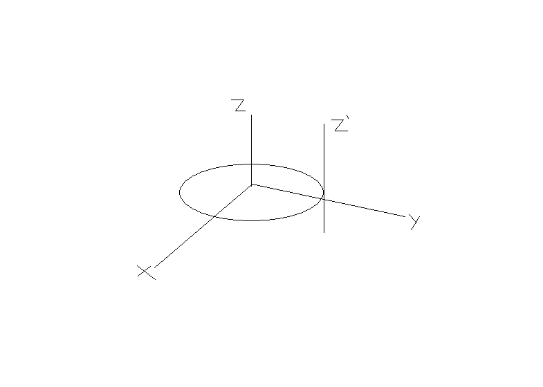

What is I for a disk?
I think its (3/2)mr^2
I don't think that is correct.
Ixx=Iyy=(1/4)mr^2
Izz=(1/2)mr^2
Iz'z'=(3/2)mr^2
This is what the book gives me
tms said:
You are assuming that [itex]\sum U[/itex] is 0 at the end. Is that true?
No, I'm assuming it equals mgh-1/2ks^2
What is the z'z' axis?
I think its just saying that its rotating about that axis. Izz is rotating about the z axis and Ixx is rotating about the x-axis and so on
Yeah, I get that part. My question is what is the z'z' axis?
I'm guessing its the pin?
Not sure where the pin is but, based on your second diagram, you are not being consistent when applying the parallel axis theorem. I would take I about the z-z axis instead.
ok so it would be (1/2)9(.075)^2+9(.525)^2 for the disk?
Looks better. Does it give the right answer now?
No, for I I got 2.91 and solved it like I how I did before and got 3.60rad/s
Ok, no surprise I guess.
Can you show your calc for mgh?
15(9.81)(.405)= 59.6
OK, I see your mistake now. Your kinetic energy included a translational term but all the kinetic energy here is rotational only. Try and see if this gives the right answer.
