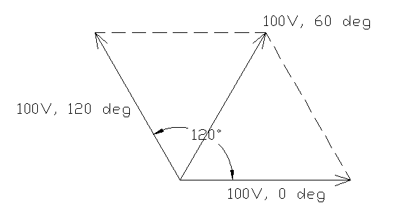

The problem is usually best visualised using vector addition.

Sorry, I said addition earlier, it should be subtraction.
It's best to look at one of the phases as being a reference, say 0 volts, then the other phase is the vector difference of the 2 phases. (yes this is superposition)
Lets say,
100V 0[tex]\phi[/tex] and 100V 120[tex]\phi[/tex]
[Isert maths here] <--- I'm at work
And you get the resultant vector as 100[tex]\sqrt{3}[/tex] -30[tex]\phi[/tex], this is the Voltage between the 2 phases. It has the same frequency, just and different magnetude and phase.

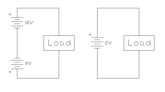

You don't need to have one line positive and one line negative in order to get current to flow. All you need is a difference in potential.
For example, in a DC circuit, you could supply a load with 2 different positive voltages, say 10V and 8V, you would have a potential difference of 2V. Therefore the circuit would be the same as if it were supplied by a single 2V battery where the positive side of the 2V battery would be pointing in the same direction around the circuit as the 10V battery did. (see attachment)
Also, if you have 2 equal voltages from different phases, you still have a potential difference, and therefore you will have current flow. For instance, say you have one leg measuring 100V at 0 degrees, and another leg measuring 100V at 120 degrees, there is a potential difference of 100V at 60 degrees. This can be shown using vector addition (see attachment).
Note that the only time the voltages between any 2 phases of a 3-phase system coincide is at plus or minus 60V.

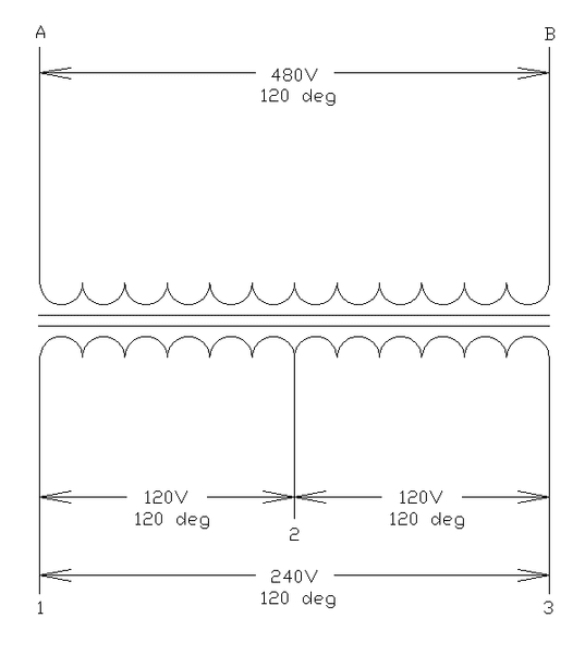

Yes and no:
This is the similar to having a single phase transformer where the secondary is center-tapped (as far as those 3 wires are concerned). The fact of the matter is that a single secondary coil can produce only one phase (one sine wave). You don't create another phase by tapping off that coil, you create 2 voltages that, when added together give the total voltage produced by the coil (end-to-end). These voltages are shown by sine waves having amplitudes less than that of the full voltage; these amplitudes, when added together, will be equal to that of the full secondary voltage. If these voltages were indeed 180 degrees apart, they would add to be 0V, rather than 240V. The reason most people think they see them as being out of phase by 180 degrees is because they are reversing the o-scope leads with respect to each other.
To illustrate this point, reference the attached pic.
The secondary voltage, measured from point 1 to point 3 will either be in phase with the primary voltage, measured from point A to point B, or it will be 180 degrees out of phase from the primary voltage, depending on how the transformer was wound and/or how the secondary taps were labeled. Either way, the secondary coil produces a single voltage, from which several voltages can be tapped off. This gives you voltages that are less than the full voltage but in phase.
Let me clarify:
Suppose you have an o-scope capable of measuring 3 signals at once.
Place the channel 1 ground clip on lead #1 and the channel 1 probe on lead #3; you will get a 240V sine wave.
Now, place the Ch 2 ground clip on lead #1 and the Ch 2 probe on lead #2; you will see a 120V sine wave that is in phase with the 240V sine wave measured by Ch 1. That is, it will rise and fall at the same time as the Ch 1 waveform, but only by 1/2 the amplitude.
Next, place the Ch 3 ground clip on lead #2 and the Ch 3 probe on lead #3; you will see a 2nd 120V sine wave that is in phase with the other 2 waveforms.
Notice that the ground clip for each channel is to the left of its corresponding probe.
What most people do, is place the ground clips of both channels 2 and 3 to lead #2 (the center tap, which is generally grounded), then place one probe on lead #1 and the other on lead #2. This will give you 2 waveforms that read 120V each, but they will appear to be 180 degrees out of phase. This is because the order of the probes has been reversed for one channel in relation to the other.
This is the same as measuring 2 D-cell batteries in series. Each battery measures 1.5V by itself, but the combination of the two measures 3V. If you were to place the negative lead at the center point of the two series-connected batteries and measure the ends of the combination with the positive probe, you would get +1.5V for one battery, and -1.5V for the other (they would appear to be "out of phase" with each other.
So, in actuality, the two 120V sources obtained from such a set-up are in phase with each other, but are 180 degrees out of phase with each other with respect to the center tap.
