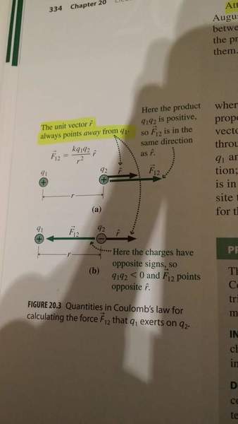

In my textbook, it states that given q1 and q2 where both charges are positive and of equal magnitude, the unit vector r-hat always points away from q1. Why is this so?
What if both charges are of opposite charge? Does r-hat still points away?

Yes I do. But how do I upload it? I do not have a scanner so the only option is to utilize my phone's camera.
Ah, now I see what's going on. Chestermiller is right.
When using Coulomb's law in vector form, that unit vector always points outward from q1. Then you can use the signs of q1 and q2 to determine the direction of the force that q1 exerts on q2. When they have the same sign, the force acts in the direction of the unit vector.
The unit vector just describes the direction from q1 to q2.

and if the force were from q2 to q1? the unit vector would point to the left?
In the second diagram however, the electric force is from q2 to q1 yet the unit vector points to the right of q2.
No, the unit vector describes the direction from q1 to q2. The force may be in the same direction or in the opposite direction, depending on the signs of the charges.
That's right.
