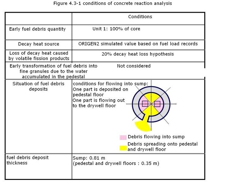

From the INL portal.
"Enhanced Ex-Vessel Analysis for Fukushima Daiichi Unit 1:
Melt Spreading and Core-Concrete Interaction Analyses with MELTSPREAD and CORQUENCH"
https://fukushima.inl.gov/PDF/MELTSPREAD%20CORQUENCH%20Analysis%201F1%20ORNL_ANL%20Feb2013.pdf [Broken]
