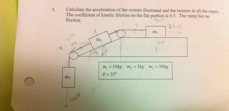

How Do I Calculate the Acceleration of a System with 3 Masses and 2 Pulleys?

ive been stuck on this for 2 days.. i tried splitting the problem into 2 weights and then considering the last mass but NOTHING. i tried SO MANY attempts NOTHING WORKS and its starting to make me angry. the block on the flat surface has a res of 250N and the fapp of the other 2 masses combined is only 130N. HOW DOES IT MOVE? PLEASE help me !
I will leave this to someone who has more of an idea of what they are doing, the only thing i can see is that you have wrote down the angle as 30 degrees on the diagram when it says 35 degrees in the box underneath. Other then that I'm at as much of a loss as you are.
oh no sorry about that, i only used 30 because i wanted to do the numbers in my head rather than do sin35. please pay no attention to my writing
Draw a Free Body Diagram for each block.
ive done all that on a separate paper, i came to a conclusion that there is no acceleration but the question fully asks to solve for a... I am so lost i really don't know what to do
If you draw a FBD for each mass you should end up with 3 equations and 3 unknowns. The key considerations are (1) the acceleration of each mass is the same, and (2) the tension between m1 and m2 is different than the tension between m2 and m3.
If you tell us the F=ma equation you got for each mass we can help guide you.
i can't get my head around the whole thing..
m1 =
fnet = ma
100 + (-T1) = 10a
m2 =
fnet = ma
50sin35 + (T?) + (-T2) = 5a

You pretty much have it. Looks like you are using g = 10 which is ok I guess. For equation 2, the T is T1 because the tension between m1 and m2 is equal and opposite. Also, you might want to double check your geometry, I'm not sure sin35 is right. In summary, you have 3 equations you can solve for T1, T2 and a by substitution:
1. 100 - T1 = 10a
2. 50sin35 + T1 - T2 = 5a --- verify that sin35 is correct
3. T2 - 150 = 30a

according to my work, a = 0 because the combined applied force of m1,m2 is less than the res of m3.
can anyone verify?
I get the same result, that there will be no acceleration. Seems a bit odd, but there's nothing in the question that prevents that from being the right answer.
I think you need to assume the system is already in motion otherwise the coefficient of kinetic friction wouldn't apply. The acceleration will depend on which direction the system is moving.

With the given information, the problem is ambiguous. You need to make additional assumptions to come up with answers, so just state what those assumptions are and give the corresponding result. There are effectively only three possibilities: the system is already moving to the left; the system is already moving to the right; and the system is at rest (in which case you need to make an assumption about static friction).
for the sake of the question, assume its going to the left.

OK, if you're going to assume it's going to the left, you should be able to solve the problem. Give it a try and if you have problems, post what you do. (After all, it is your homework :wink:)
i got 0.13 for a.
and T1 tension was 110N which is greater than 100N the gravity force acting down for m1.

Yes, it's possible, even expected, for T1 to be greater than 100N. You start with m1 moving downward, but slowing down, so its acceleration is upward.
T1 - m1g = m1a > 0
so, T1 > m1g .

since you only were given the coef of kinetic friction i would assume the that the system was already in motion. If your accel was negative then that means the system for that instant was slowing down. It would be better if the question gave a little more information.
