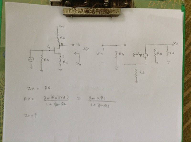

Hi everyone,
I have attached an image of fet amplifier in common source configuration. I want to have the ac analysis of this circuit. I am able to figure out the input impedance and the voltage gain. But I can't formulate for output impedance.
According to me, while calculating output impedance input should be zero. As soon as vs becomes zero the value of current (gm Vgs) will be zero. So the current source will behave as an open circuit. And we get (Rd||rd). But according to book it's wrong.
Can anybody help!
Thanks in advance.

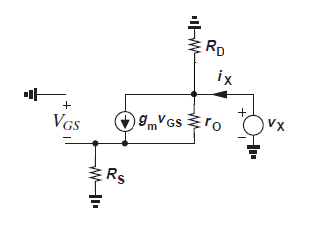

No, that completely wrong. rd = ro = ΔVds/ΔId at constant Vgs - is a small-signal internal resistance parallel to the gm*Vgs current source. But not equal to 1/gm.
So you need to use this small-signal model to find output impedance.
Zo = Vx/Ix

as far as my understanding says, gm= Id/Vgs and if the slope of characterstic curve is constant the gm can be approximated as rd. Please correct me if i am worng.
In the image attached by you the current source should be open because at the time of calculating output impedence we remove input voltage source. since Vgs=0, current source is open circuit. so if we remove the current source then the output impedece will be, Zo=(ro+Rs)||Rd.
Is this the way to do it?

Yes is is true that when we calculating output impedance we short a input voltage source.
So we connect the FET gate to ground. But we also replace the load resistance with a Vx test voltage source. So we can find Zo = Vx/Ix
So if you look at the circuit diagram
You will see that Vgs is not equal 0V (only gate is connect to GND) not the source.
Vgs = -Is * Rs
Test voltage provide a current for Rs resistor so there will be a voltage drop across Rs resistor, so the gm*Vgs current source is not a open circuit. There will be additional current flow through Rs resistor. Is = Iro + (gm*Vgs).
But if we remove ro resistance from our small-signal model, then Vgs is indeed equal to Vgs = 0V, current source is open circuit. The output impedance will be, Zo = Rd.

so Vo=Vds+Vs
where, Vds = (Io-gmVgs)*(ro||Rd): here Vgs=-Vs
Vds=(Io+gmVs)*(ro||Rd)
Vs=Rs*(Io) sum of current source and ro current will be the source current.
Vo=Vds+Vs
Vo=(Io+gmVs)*(ro||Rd)+(Rs*Io)
or
Vo=((Io+gm(Rs*Io))*(ro||Rd))+(Rs*Io)
Vo=Io*((1+gmRs))*(ro||Rd))+(Rs)
Vo/Io=((1+gmRs))*(ro||Rd))+(Rs)
right...?
but textbooks says the zo=Rd/(1+gmRs).
please clear this.
Try to find Zo if you remove Rd from the circuit.
Vx - Iro•ro - Ix•Rs = 0 (1)
Ix = gm•Vgs + Iro (2)
Vgs = (-Ix)•Rs (3)
And now I substituting equation (2) and (3) to (1)
Vx - Iro•ro - (gm•(-Ix) •Rs + Iro)•Rs = 0
Now solve for Iro
Iro = (gm• Ix• Rs² + Vx) / (Rs + ro)
(4)
And substituting (4) to (1) and solve for Ix
Ix = Vx / (Rs + ro + gm•Rs•ro)
And finally
Vx/Ix = = Re + ro + gm•Re•ro = ro • (1+gm•RE + RE/ro)
Or we can write this equation
Ix•Rs + Iro•ro = Vx (1)
Iro = (Ix - Id) (2)
Id = (gm•(-Ix)•Rs) (3)
so after substitution
Ix•Rs + ( Ix - (gm•(-Ix)•Rs))*ro = Vx
next solve for I2
Ix = Vx / ( Rs + ro + gm*Rs*ro )
Vx/Ix = Rs + ro + gm*Rs*ro
so now if we add Rd resistor we have this 'exact' value
Rout = Rd||(ro+Rs+gm•ro•Rs) = Rd||( ro •(1+gm•Rs + Rs/ro) )
This expression, Rout = RD || (ro * (1 + gm * Rs)), is a good approximation provided that ro >> 1/gm.

Hey thanks a lot. I get it where I was wrong. I thought that ro is directly connected to ground but it's connected to Rs. That's why I am taking Rd||ro.
Thanks a lot again.
