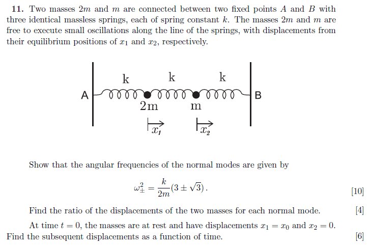

Two oscillating masses on springs in one dimension
In summary: F=ma. When the masses are displaced, the springs exert a restoring force on the masses that tries to return them to their original positions.
99wattr89
I can't make this question work, so I'm hoping that someone here will be able to help guide me towards a solution.
I began with F=ma, and wrote down the equations of motion for each of the masses.
a) 2mx..1 = -kx1 -k(x1 -x2)
and
b) mx..2 = -kx2 +k(x1 -x2)Then I added b to a, and subtracted b from a to get;
c) m(2x..1 +x..2) = -k(x1 +x2)
and
d) m(2x..1 -x..2) = -3k(x1 -x2)Then I added d to c, and subtracted d from c to get;
e) mx..1 = -kx1
and
f) mx..2 = kx1 -2kx2I then tried to solve e, using the trial solution x1 = αcosωt + βsinωt
But I don't have boundary conditions, so I can't find α and β, just ω, which I found to be √(k/m)I then tried putting this expression into f to allow me to solve it for x2, but I realized that I could only solve it if the ω term associated with x1 was the same as the ω term associated with x2 - otherwise the sin and cos terms can't be canceled out. And if ω is the same for both then my method has to be wrong anyway, because I'm meant to find two values for ω, and as the question states, neither is √(k/m)Can anyone help me here?
Thank you.

I've had lectures on Lagrangian mechanics, but even after the lectures I still don't have a clue how it works, so that probably wouldn't be very fruitful. I also don't have a copy of Taylor sadly.
The derivation you linked uses the same sort of method as the one I followed to get to this point, but the matrix method is new. Thank you for linking it - following it I got to the answer for the first part of the question.
For the second part I got that the amplitudes were A = 0.5(1-√3)B and A = 0.5(1+√3)B for ω2+ and ω2- respectively. (A = x1 amplitude, B = x2 amplitude.
Unfortunately that creates a problem for part 3 - if A and B are related by a factor of 0.5(1±√3) then that seems to prevent a solution. Because it says that x1 = x0 and x2 = 0.
So if x2 = 0 at t=0, that means that since x2 = Beiωt, that B must equal zero. But that means that there's no oscillation at all, because A is a multiple of B!
Include a phase factor in your solution.
[itex] x_{1} = A*e^{i (\omega t +\delta_{1})}[/itex]
Similarly for the second wave vector. Now retain the amplitude relationships and use the phase factor [itex]\delta[/itex] to allow for zero values at time t=0. It may be more useful to use sine or cosine functions at this point because the exponential function is only zero as [itex]\delta[/itex] approaches negative infinity. The trigonometric functions, on the other hand, can equal zero.

You made a mistake in e). It should be the same as the original equation a).
The general motion of such a coupled vibrating system is the linear combination of the normal modes: collective SHM of the particles with the same frequency and defined ratio of amplitudes.
Suppose the displacements as [itex]x_1=A_1e^{i\omega t}[/itex], [itex]x_2=A_2e^{i\omega t}[/itex]. You get a linear homogeneous system of equations for A1 and A2 which has non-zero solutions for certain ω values. Replace back these ω-s and you get the ratio of amplitudes for the normal mode with angular frequency ω. The general solution is linear combination of the normal modes belonging to the different angular frequencies and different relative amplitudes for x1 and x2.
ehild
Choose B=1. You can consider the normal modes as two-dimensional vectors: [A+,1]exp(iω+t) and [A-,1]exp(-iω+t) and the general solution is a linear combination of them.
That is:
x1=aA+exp(iω+t)+bA-exp(iω-t),
x2=aexp(iω+t)+bexp(iω-t).
ehild

You have found the frequencies the system can vibrate with, and the relation of the amplitudes of the separate masses. ω+ and ω- are the angular frequencies of two special vibration of the system: when both masses vibrate with the same frequency and phase constant at a fixed ratio of their amplitudes. Such normal modes can be considered as the basis of a two-dimensional vector field of possible motions of the system of the masses and springs. The general motion is linear combination of these normal modes.
Using + and – to distinguish between the normal modes, the displacement of the masses are
[itex]x_1^+=A^+\cos(\omega^+t+\phi^+)[/itex]
[itex]x_2^+=B^+\cos(\omega^+t+\phi^+)[/itex]
[itex]A^+=0.5(1-\sqrt{3})B^+[/itex]in case of the mode with ω+ angular frequency, and
[itex]x_1^-=A^-\cos(\omega^-t+\phi^-)[/itex]
[itex]x_2^-=B^-\cos(\omega^-t+\phi^-)[/itex].
[itex]A^-=0.5(1+\sqrt{3})B^-[/itex]
One of the amplitudes in both modes is arbitrary: You have chosen the B-s.
The general motion (I will denote the displacements by capital X1, X2) is linear combination of these modes. As the B-s are arbitrary they can be considered as the constants of the linear combination.
[itex]X_1(t)=A^+\cos(\omega^+t+\phi^+)+A^-\cos(\omega^-t+\phi^-) [/itex]
[itex]X_2(t)=B^+\cos(\omega^+t+\phi^+)+B^-\cos(\omega^-t+\phi^-) [/itex]You need to find B+,B- and the phase constants from the initial conditions: X1(0)=x0, X2(0)=0, dX1(0)/dt=dX2(0)/dt=0. ehild

EDIT: I like this problem a lot, so I decided to work it the way you gave up on to show you what you could have did. I uploaded pics of my work to imgur since they're huge.
http://i.imgur.com/38KBL.jpg
http://i.imgur.com/xBzp9.jpg
I'll let you do the hard work on the third part of the problem using the initial conditions.
The reason I like this problem so much is I just learned how to do it yesterday! :approve: MIT OCW taught me how. http://ocw.mit.edu/courses/physics/8-03-physics-iii-vibrations-and-waves-fall-2004/video-lectures/lecture-5/ (not to advertise or anything...).
wotanub,
Your solution is nice, but I have noticed that you used the same notation (x1,x2) for the displacement in a normal mode and in the final solution. They are not the same!
The phase factor is not needed for the normal modes, but it has to be included at the final solution to fulfil the initial conditions.
As the solution gives the square of the angular frequency, the general solution contains both a sine and cosine term for both normal modes, or a cosine(sine) with phase factor.
The present initial conditions (zero initial velocities) result in zero phase constants. If there are nonzero initial velocities, pure cosine terms would not do. (Why?)
ehild

Your solution is too specific. The general solution of the differential equation implies both exp(iωt) and exp(-iωt) (in complex notation) or both sin(ωt) and cos(ωt) or cosine/sine with a phase factor.
The solution in my post #8 can be fitted to any initial conditions.
ehild
I think I see why. X1,2 represent the changing position of the two masses over time as a combination of the normal modes, and the magnitude of each mode relative to the other is determined by the A and B values.
But how do you find the B values and phase constant? Everything I've read or looked up never explains the process for solving any of this, it just says 'and then you solve it'. I'm getting desperate, since this question and the other I posted about have eaten more than two weeks of my time now, and I have a lot more work I have to do before Friday (the deadline).

I followed through your working, but I think you made a mistake early on, and got a minus sign where there should be a plus in the initial equation 1, because your method is the same as mine but for that, and I get a different relationship between A and B.
Unfortunately I have absolutely no clue how to do the third part of the question.
Plug in t=0 into the expressions for X1(t) and X2(t). You get:
[itex]X_1 (0)=A^+\cos(\phi^+)+A^-\cos(\phi^-)=x_0[/itex]
[itex]X_2 (0)=B^+\cos(phi^+)+B^-\cos(\phi^-)=0[/itex]
[itex]B^-\cos(phi^-)=-B^+\cos(\phi^+)[/itex]
Use the relation between the A-s and B-s, you get
[itex]B^+\cos(phi^+)=-x_0/\sqrt{3}[/itex]
[itex]B^-\cos(phi^+)=x_0/\sqrt{3}[/itex]
Do the same with the derivatives:
[itex]\dot X_1 (0)=-A^+ \omega^+\sin(\phi^+)-A^-\omega^-\sin(\phi^-)=0[/itex]
[itex]\dot X_1 (0)=-B^+ \omega^+\sin(\phi^+)-B^-\omega^-\sin(\phi^-)=0[/itex]
[itex]B^- \omega^-\sin(\phi^-)=-B^+\omega^+\sin(\phi^+)[/itex]
[itex]-0.5 B^+ (1-\sqrt{3})\omega^+\sin(\phi^+)+0.5 (1+\sqrt{3})B^+\omega^+\sin(\phi^+)=0 \rightarrow \phi^+=0, \phi^-=0[/itex]
ehild

So the phi terms have to be zero because the coefficients are non-zero and sum to root3 times B+ω+, meaning that the sin terms have to both be zero for all values of B and ω. Is that right?
And should the final answer be left in terms of B and not x0 or something like that?
Yes.
The final answer should include xo.
ehild
