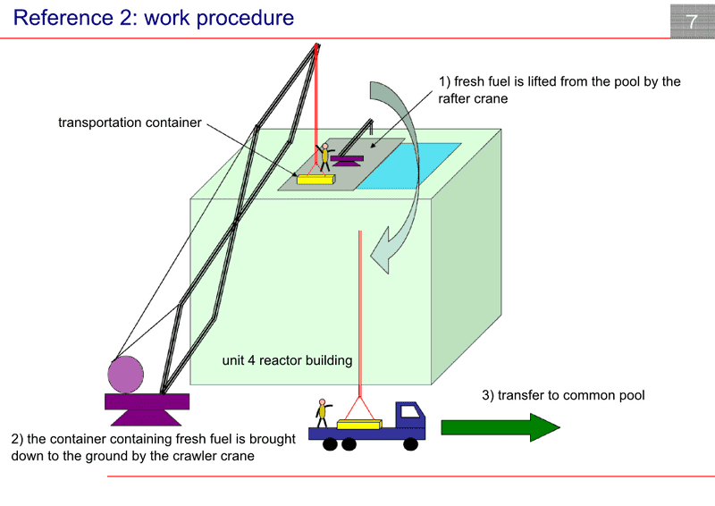

Some things need to be included in considering offloading fuel with an external crane:
1. Debris or damage to fuel assemblies in the pools may make movement risky of further damage and radiation release.
2. Fuel assemblies are easily damaged by side loads so they need to be supported in whatever vessel or tank is used for the transfer.
3. If you provide sufficient support to prevent damage during transfer you need very fine control of location and speed of movement into the transfer support.
4. Movement in air will cause rapid heating and very intense radiation fields.
5. The transfer will be exposed to wind and elements.
6. A commercial grade crane could fail during transfer. If the assembly is out of the water when this happens it could get dicey. If the failure results in a dropped rod that would be bad.
7. What happens if there is another seismic event during transfer?
Supporting and protecting the pools and leaving the fuel there may not be best option but it also might not be the worst.
Very true, and I've thought about all that for the most part. To focus only on point 6, what are the statistics for industrial crane accidents? I'll bet the probability of an accident is less than the probability assigned by the designers of the plant to the possibility of a magnitude 9 earthquake and a 15m tsunami. And there are probably hard statistics to back that up, as opposed to just pulling it out of thin air and calling it my design basis.
Sorry for the snark :) Precautions would obviously be necessary. You don't paint without a dropcloth, cameras for observation underwater and above would be required, the vehicular transfer tanks would need the proper supports inside... all true. My opinion is it would still entail less risk than letting all that spent fuel stay 30 meters in the air for another year waiting for another earthquake. It all would depend on whose Probabilistic Risk Assessment numbers you believed. I sincerely do not believe such a plan would necessarily entail any more risk than they've already signed on for.
Thanks for the considered response, and again my apologies for the snark :)

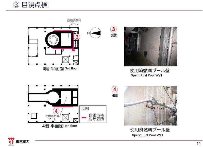

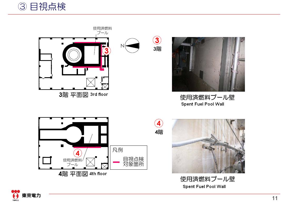

The pillars were included in the FEM analysis presented in a press release on 28 May : http://www.tepco.co.jp/en/press/corp-com/release/11052801-e.html , and the result is that they improve the safety margin against earthquakes. The 3D model including the pillars is shown on figure 1 page 115 (attachment 4-4-1) of http://www.tepco.co.jp/cc/press/betu11_j/images/110528b.pdf

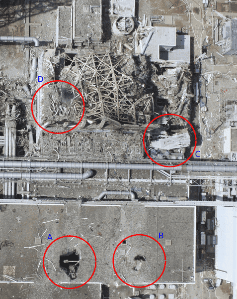

  • #9,397
SteveElbows said:
I am left wondering how it could possibly have been determined, that a fire was ongoing -- concurrent with the explosion -- in the oil of the recirculation flow control system M/G sets.
If they eyeballed a fire at that location once the initial dust from the explosion died down, they may reach that conclusion.
However, that would be a non sequitur, would it not :-)
Anyhow -- on a photo of the location once the initial dust from the explosion had died down there appears to be not one iota more of a lubricant fire to eyeball in the NW corner if unit 3, than there is on a photo taken 3 days later.
Here's the location 3 minutes after the explosion:
and here, the location 3 days after the explosion:

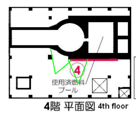

zapperzero said:
I can. For instance, some arrangement of gantry cranes, plus a wall or two might have thrown big "shadows", stopping much of the ejecta, while the rest went upwards. The outer walls of the reactor building may have reflected some of the blast, bunching up the debris cloud as it was forming. And so on and so forth.
Even if the SPF shaped the blast (which it may have), it does not follow that it was anything else but a hydrogen blast. The highest concentration of hydrogen would have been found directly above the pool, no? And the pool would have been only half-filled.
Discussion on the explosion is already buried deep somewhere in this thread. From what I remember speed of the explosion propagation heavily depends on the shape of the area (walls, columns, any other objects). No idea if that's enough to shape the explosion so that it is mostly vertical (that is, up becomes the path of the least resistance), but who knows.
  • #9,410
Building One: Hydrogen explosion.
Building Three. Hydrogen plus something else.
Building Four: Unknown.
  • #9,411
At least make an effort to argue or source... such pronouncements add nothing of value.

Thinking about Building Three, it is highly probable that the building was full of not just hydrogen, but a lot of moisture. (this probably came up before, but I don't recall it at the moment)
If the hydrogen level was high, there wouldn't be enough oxygen to allow it to all oxidize at once, which clearly Building One suffered from. So the initial blast which clearly blew out the side allowed oxygen rich air to suck in, and the rest of the hydrogen went, but at the same time heating the moisture inside to turn into superheated steam, which would explain the obvious steam explosion. Obvious in the sense it clearly was not the type of instant flash you would see with a big hydrogen/oxygen explosion alone.
Experiments with concrete models and hydrogen, and hydrogen and a lot of moisture might actually learn us something about what can happen when you combine superheated boiling water pools, hydrogen, burning nuclear fuel rods, cesium hitting water, and various oils, gases and such, when it all goes terribly wrong.
There would, if the hydrogen were to have been created by radiolysis of water into H2 and O2.
