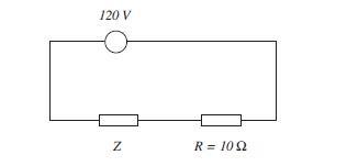

For the circuit given in the power factor is 0.72 lagging and
the power dissipated is 375 W.
Determine the:
(1) apparent power
(2) reactive power
(3) the magnitude of the current flowing in the circuit
(4) the value of the impedance Z and state whether circuit is inductive or
capacitive.
(1) Apparent power = True power / Power Factor (S=P/pf)
= 375 / 0.72
= 520.8333 VA
(2) Reactive Power = SQRT (apparent power^2) - (True Power^2)
= SQRT (520.8333^2)-(375^2)
= SQRT (130642.3264)
= 361.4448 VAR
(3) Magnitude of Current
Power= Voltage*Current *Power factor (P=V*I*pf)
375 = 120*I*0.72
I = P/(V*pf)
I = 375/(120*0.72)
I = 4.34 A
(4) Total ohms = Voltage/Current
= 120/4.34
=27.6498 ohms (minus 10)
z = 17.65 ohms
The power factor is lagging within the circuit therefore the the virvuit is inductive
Am i on the right lines here? or is there a better way of calculating the above results
I find your calculation of total ohms (part 4) to be a bit dubious. Where you've made the assumption that you can just subtract the resistor value from the impedance magnitude to leave the impedance Z of the "mystery component" is also suspect. Impedance will have real and imaginary parts.
I'd be more inclined to use the current magnitude and its known phase angle obtained from the power factor to construct the complex current: [itex] i = I (cos(\phi) - j\;sin(\phi)) [/itex], and then find the total (complex) impedance of the circuit:
[itex] Z_{tot} = \frac{120 V}{i} = (19.91 + j 19.19) \Omega [/itex]
Then subtract the given resistor from the real part of that to leave the impedance Z.

Think I've got it;
i=4.34(cos(0.76699)-jsin(0.76699)
i = 4.34(0.720003-0.693971)
i = (3.12481-3.01183j)
So
Z=120/(3.12481-3.01183j)
Z=19.9079 + 19.1882j
Minus ten from real gives
9.9079 ohms
This better? Are my answers ok for the other parts of the question?
Yes, that looks better. So the "mystery component" has both resistance and inductance.
The other answers look fine to me; nicely calculated. :smile:

If you look at the image attached to the first post you'll see that the load consists of some unknown impedance Z in series with a 10 Ω resistor. The given information was used to calculated the total impedance of the circuit, so Z + 10 Ω. By subtracting the 10 Ω we're left with Z alone.
