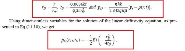

Hi,
I am trying to incorporate the following equation into Matlab in the red:
http://http://www.radikal.ru][PLAIN]http://s018.radikal.ru/i518/1305/16/1cc0d2a72d38.jpg
The following data is to be used:
t=3000000
nr=nx=161
q=0.02

Here is the equation to be solved :
The red equation belowi the analytical solution I want to get solution for.

t is a constant.
st=size(t) is then equal to [1 1]
the for loop runs through for i=1, but then halts on i=2 because you have t(i), and t(2) doesn't exist.
