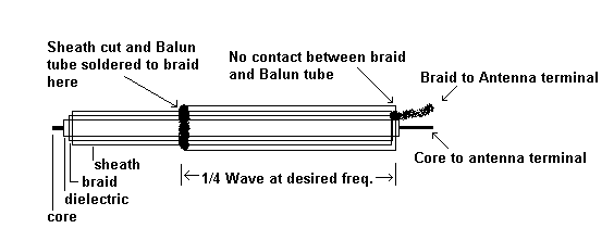

A 1/4 wave matching section is usually a 1:1 BALUN ... its purpose is more usually to match the unbalanced coax to the balanced input of an antenna. Being a 1:1 balun there is no impedance transformation. The secondary purpose of this balun is that it stops RF current flowing back down the braid of the coax and it then becoming a radiator.
hope these thoughts help :smile:
Dave

Okay, so basically it's a quarter wave because in a quarter wave, the impedance goes from a minimum (at, say, the beginning of the line) to a maximum (at, say, the end of the line) and so basically the sine wave (representing the impedance) can then be scaled to meet the requirements of input and output impedance.
What was confusing me was that they have Z_L in the formula when really, Z_L is not the load impedance but rather, the impedance that is seen when looking from the load into the impedance line.
