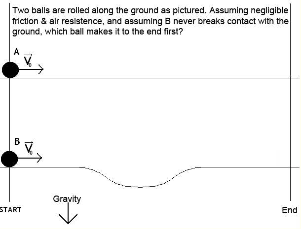

I found this picture somewhere:
My question being, as in the picture, which ball gets to the end faster? I guess you could naively say that ball A reaches the end in less time, but then again, there is the force of gravity which would accelerate the ball going downwards (and deaccelerate it going upwards, respectively). In essence, the question really might be: does the gravitational pull accelerate the ball to a high enough velocity to compensate for the increased distance? I hope I'm going into the right direction with this, but I certainly lack the mathematical/physical knowledge to solve this (could the conservation of energy be used?).
I'd appreciate any input.

I used to think it was obvious -- ball B has a higher average velocity, since its velocity is always greater than or equal to ball A. But on the other hand, ball B has to travel farther. Hmm.
So try picking a couple simple dip geometries to calculate the time it takes for the ball to make it across. Show us your calcs -- we are all interested in the correct answer... :smile:
I figured that the increase in distance traveled is a linear function of the depth of the dip, as is the increase in the ball's energy as it drops that distance. Speed goes as the square root of kinetic energy, so the distance traveled should increase more rapidly than the speed and A wins the race.
The question is, can the horizontal component of the velocity vh ever become smaller than v0?
The only force that can reduce vh is the normal force. On a down-slope the horizontal component of the normal force points forward, so vh can only increase. If the hole was symmetrical, we would now be done, because vh on the up-slope would have to be the same as on the corresponding point on the down-slope, so vh >= v0 everywhere.
It seems possible to think of a real steep up-slope, that could reduce vh[/SUB to smaller than v0, but if that happens, the vertical component of the velocity would become so large that the ball would jump up above the starting level.
Is there anything changing the horizontal component of either of the balls' velocites?
Unless there is, it looks like a tie, to me.

Yes there is, it is a component of the normal force (it is normal to the surface orientation and not normal to horizontal velocity) from the cavity surface that increases horizontal component [itex]v_{h_B}[/itex] to a velocity [itex]v_{hmax}>v_0[/itex]. That is during the descent of ball B. During the ascend we have again the component of the normal force that decreases the horizontal velocity from [itex]v_{hmax}[/itex] back to [itex]v_0[/itex].
The total horizontal displacement is the same for both cases but because ball B has a time interval where its horizontal velocity is bigger than [itex]v_0[/itex], ball B wins the race.
I do not like the tie, as that would imply that a deeper hole will still end up in a tie, yet gravity is limited and a slightly deeper hole will clearly slow B regarding to A.

There's a limit to how deep the hole can become without the ball B losing the contact with the ground. As long as the normal force points upwards it will also point forward on the down-slope, and the horizontal velocity can only increase. If the normal velocity points downwards, the horizontal velocity could decrease, but this can only happen if ball B can't leave the ground. (if it's in a tunnel for example). If the horizontal velocity of ball B can't decrease, ball B can never be slower than ball A.
On a better thought this problem can have 2 solutions (if the never breaks contact statement holds) affected by the "ratio" of vo and g.
A very low speed with normal g will favor B.
A very high speed with normal g will favor A. As the hole will act as a bump (never breaks contact).

If I drive a car off a cliff, the horizontal component of motion remains constant.
But, if I roll the car down a long flat incline, it will increase... because a normal force is present.
I think I see that...
So, since the horizontal component of the distance is the same for both balls, but it is ball B that spends part of its travel in the segment of the dip, within which its horizontal component velocity is always greater than ball A (because ball B's entry speed into the dip equals its exit speed, but is above Vo throughout the dip)... so ball B advances over ball A as B enters the dip and maintains the advantage it holds when exiting the dip to the end, finishing before ball A.

Yes, this is the critical observation: that during ascent the horizontal component cannot increase, yet on completing the ascent it must be back at Vo.

At a deepest point of the track, the entire velocity must be horizontal. If the deepest point is below the starting point, conservation of energy implies that the horizontal velocity is greater (greatest?) at the deepest point.

No, that's the catch. The standard brachistochrone problem is in the context of, say, bead on a wire. In the present context there's only gravity to maintain contact. The initial descent cannot be steeper than the ballistic path.
One thing that I noticed:
If I start from the energy equation without rotation:
$$\frac{1}{2}mv^2 + mgy = \frac{1}{2}mv_0^2$$
then after some manipulation I get
$$\ddot{x} = -\dfrac{\dot{y}}{\dot{x}} (g + \ddot{y}).$$
Since ##\ddot{y} \ge -g,## it follows that ##\ddot{x} \ge 0,## with equality in the case of the ballistic trajectory ##(\ddot{y} = -g).##

Now for ##\ddot{y} = -g,## the expression in the second parentheses is negative, implying that ##\ddot{x} < 0##.

Ball A, of course. Ball B will loose as much speed going up as it gained going down, and then it is left to travel over greater distance. But more distance also means more friction, so if you push them with sufficiently small speed ball B could end up in the ditch and never finish the race, or it could manage to get out but still stop short of reaching the goal.
Speed bump with the same shape upwards would produce the same result, it doesn't slow down much if the ball manages to pass on the other side, but it makes for a greater distance the ball has to travel over.
