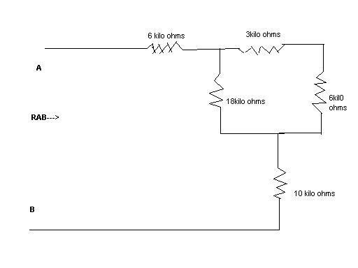

Q1) Find the equivalent resistance at terminals A-B in the circuit.

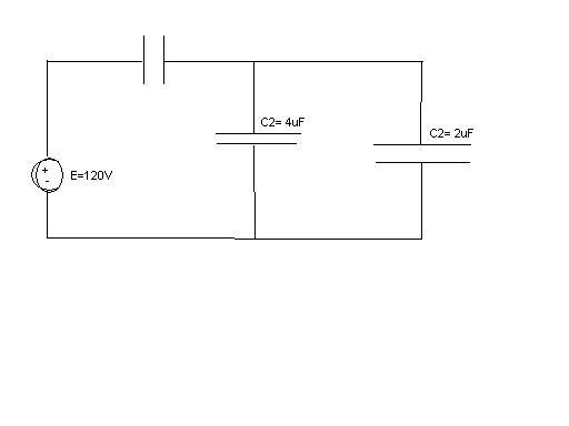

Q2) Find the voltage across and charge on each capacitor for the network below :

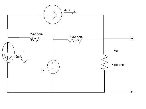

--------------------------------------------------------------------------------Q4) Find Vo in the network :

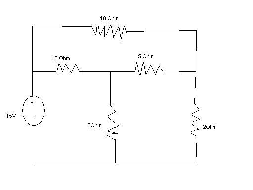

Q6) Use Mesh equations to find the current through 10 Ohm resistors.

Q1. Use the formulas for getting the total resistance of resistors in series and resistors in parallel separately.
Q2. Learn how to calculate total capacitance of capacitors in parallel

Q4. Same principles as question 1.

Q6. Read up on mesh analysis.

Qno.1)
the 3 kOhm + 6 kOhm = 9 kOhm, which is in parallel with the 18 kOhm resistor. 1/R = 1/18 + 1/9. R = 6 kOhm. So, overall, that part has 6 kOhms in resistance. adding the other two resistors that are in series, 6 + 6 + 10 = 22 kOhm. the equivalent resistance is 22 kOhms.Also Q no,3 I got help from wikipedia and I've got that done now.

The Mesh equation question is totally out of knowledge, since he taught that while I was gona and gave this assignment.

Read through your notes or textbook on mesh analysis first.
If you want to read something online, try this:
http://www.allaboutcircuits.com/vol_1/chpt_10/3.html
http://mysite.wanadoo-members.co.uk/phil_robinson/mesh.html
