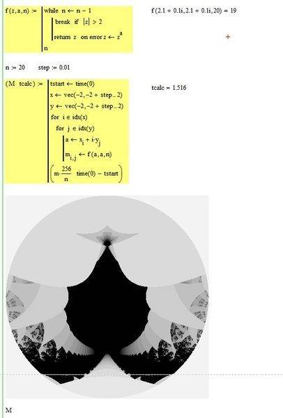

around the one and a half second mark in Mathcad 15 on a Dell Dimension 521 (Athlon 54 dual-core 2.5 GHz with 4GiB RAM running Windows 7 32-bit) - the lighter the image, the quicker the escape. Around one second for an n=64 standard Mandelbrot over the same x and y ranges.
That's interesting that yours rendered much more quickly than Bill's... Do you think that it is because your program is faster?

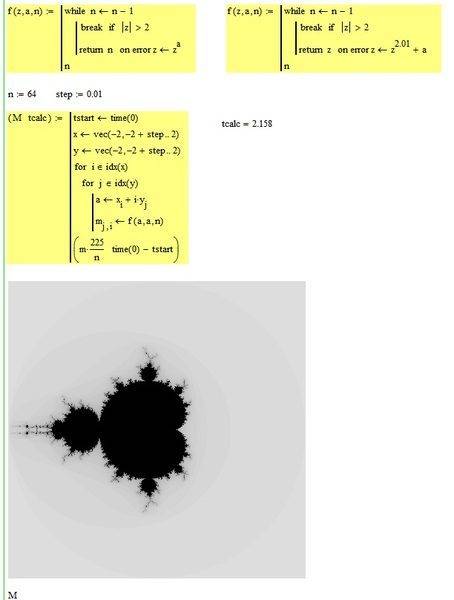

(*) The gray dotted line that goes across the plot is where the page boundary would be if I'd printed the worksheet as is - I'd move stuff around to avoid this if I was actually going to print it. The image below shows a variant of the program in which I'd shuffled the 'regions' further up the page. It also illustrates another feature of Mathcad, that is the ability to write programs across the page as well as down the page. Mathcad evaluates left-to-right then top-to-bottom. Consequently, the second function f supersedes the first definition resulting in a Mandelbrot like figure (note the power of z is 2.1 rather than 2, hence the bident rather than the single prong along the negative x-axis).

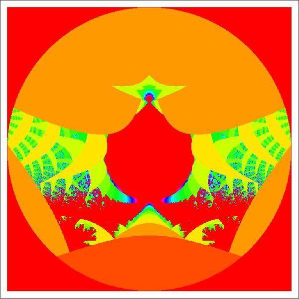

To answer your question about color, change my original simple code thus
ArrayPlot[Table[n = 0; z = a + I*b; r = z; While[Norm[r] < 3. && n < 20, r = r^z; n++]; n, {a, -3., 3., .01}, {b, -3., 3., .01}], ColorFunction ->Hue, ColorFunctionScaling -> True]

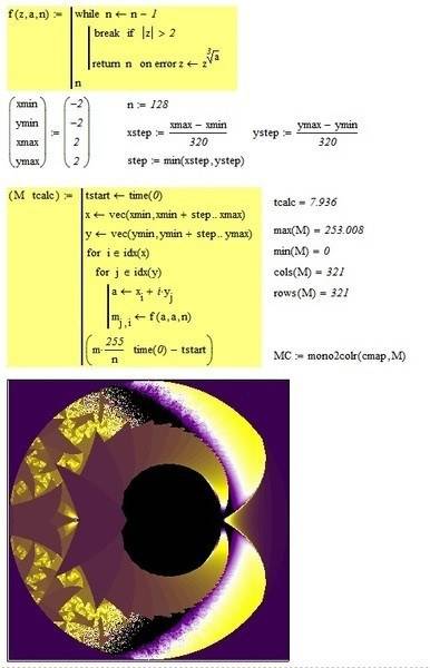

b. Yes, see image below. It makes use of a short function mono2colr (not displayed) that indexes the count into a colour map. Note that I've changed the function to raise z to the cube root of a for this example - gives it a slightly Escher look, IMO.
c. Yes, Bill Simpson has already answered this one.
