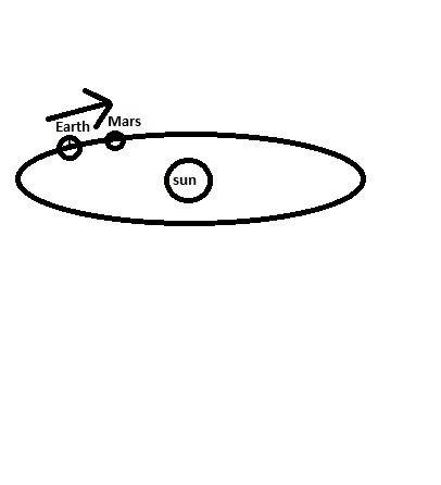

For a moment consider this assume Earth and Mars are in the same orbit (not concentric circles, just to avoid confusion and i think this has no effect)and Earth as FoR. Now when clock B is instantaneously transported to Mars it shows less than 1 second after reaching mars(clock A on Earth shows 1 sec).
I'm afraid you've lost me here. If Earth and Mars are in the same orbit (the same distance from the Sun), then they will experience the same time dilation and their clocks will remain about 1 second apart.

i had this in mind. as Mars revolves slowly in Earth FoR i considered clock B as coming back to earth.and what is the below comment i don't get how
But if you move Mars to the same orbit as Earth, then it won't travel slower than the Earth like it does at its orbital distance from the Sun. It will travel at the same speed and remain the same fixed distance from Earth. In the non-inertial rest frame of the Earth, Mars is also at rest so the two clocks would tick at exactly the same rate.
Did you think maybe that Mars orbits the Sun slower than the Earth because it is smaller?

It's always challenging to figure out what happens in a non-inertial FoR which is what Earth's FoR is. Why do you want to torture yourself like that? Just work it out in the Sun's inertial FoR like your diagram shows and it will be super simple.
Are you are proposing that the Earth and Mars are in the same orbit but Mars has a rocket that slows it down (which would then actually take it out of Earth orbit, but we'll overlook that) with the idea that Mars will slowly get closer to the Earth until they meet? And you're wondering if this is like the Twin Paradox? Sort of, the clock that went to Mars and returned will have less time on it but mainly because it got most of that time difference during its high speed trip to Mars. On the slow speed return, even if it is traveling slower than earth, it would never be enough to overcome the initial one-second loss of time.
But to be precise, in the Twin Paradox, to make the solution obviously simple, one of the twins remains inertial. We usually call that the Earth twin but we have to pretend that the Earth is inertial and not orbiting the Sun. If both twins experience acceleration, then we have to carefully consider the velocity profile of each twin to determine which one is younger when they reunite.
yes!
precisely...
you got me!
but what i also assumed is all these happen in a duration within which the path traced by the Earth is almost a straight line so no acceleration and qualifies as inertial frame so what's wrong here?
Now that you explain it fully, there's nothing wrong. So you could consider the rest frame of the Earth and the clock travels at high speed from Earth to Mars and then Mars travels with the clock back towards Earth in say less than one month.
So this is exactly an example of the Twin Paradox where you have one clock on Earth that keeps normal time and one clock that makes a high speed trip away from Earth and a slow speed trip back to Earth and ends up with less time on it.
Does that make sense?
