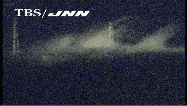

razzz said:
NHK, Japan's national broadcaster, positioned a TV camera 33 kilometers southwest of the plant, and broadcast the helicopter operation live. At 9:48 a.m. local time a helicopter flying from the west dropped the first load of water almost directly over the No. 3 reactor, though a significant amount spread away from before reaching the target.
http://spectrum.ieee.org/tech-talk/energy/nuclear/helicopters-and-cannons-spray-water-on-japans-unstable-nuclear-plant" Field of view is about the same in this video after appox. 30secs as with the #3 explosion video. A good guess for syncing a sound track.
the videos for the helicopter sprinkling are most likely taken from this location http://watchizu.gsi.go.jp/watchizu.html?b=371307&l=1405230 at an elevation of 750-830 metres and 27 km distant from the NPP and this is not the same location as the videos from the explosions. Using google Earth and maps I cannot find a good location at 33 km distance - possibly the reporters just stated this distance to comply with the 30kM exclusion zone.[PLAIN]http://k.min.us/inr320.JPGThe videos of the explosion, in my opinion, were taken from this point http://watchizu.gsi.go.jp/watchizu.html?b=372016&l=1405540 which is 13km and at an elevation of 582metres. This point also seems to be TV or radio station as a mast and a building is visible on google earth.
Using Google Earth one can draw site lines and check features like the high voltage line towers (vertical lines in the middle of the foreground)
[PLAIN]http://k.min.us/inr1us.JPG
