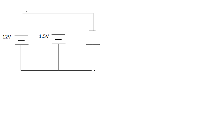

Let's say you have a 12volt battery and a 1.5volt battery and you hook them in parallel. The 12v will want to push current through the 1.5 volt battery the wrong way. If the 1.5volt battery blocks current that tries to flow through it in the wrong direction then the effective circuit is a 12volt battery and the 1.5 volt battery is not really there.
If the 1.5 volt battery does NOT block reverse current, then it will be swamped with reverse current from the 12volt battery and it may well explode or at the very least be irreparably damaged.

let me draw a picture of the circuit or could you possibly do that for me? with comments on it labeling every process/action? I'm not good at learning through words only as it is very confusing for me. i could use an animation to learn best as well but i don't know how to use flash animation to do that.
phinds, here is a simple diagram i made. hopefully you can edit it to your explanation

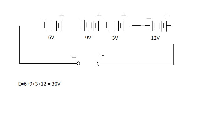

here is a diagram i drew myself of voltage sources in series.

so why is a negative terminal of the "main source battery/MSB" connecting to a negative terminal of another 6V battery? just explain this.
i would have thought normally negative current from negative terminal would go to a positive terminal of the same battery. what happens to the current after "MSB's negative terminal electrons reach the 6V battery's negative terminal? where does it go next? and where does it travel precisely?

you have no current because you have an open circuit.
The voltage difference between the + sign on the bottom and the - sign on the bottom is 30 V.
The voltage difference between the - sign on the bottom and the - sign of the 6V battery is 0. Does this help?

Imagine yourself accompanying one coulomb on a trip through your circuit.
We'll start at the negative terminal, ie the dot labelled - .
That dot and the wire going to the 6v battery's negative end comprise a node, and potential is same everywhere on a node(by definition).
You traverse the node and enter the battery.
Inside the battery you acquire potential energy from the chemical reactions and exit the positive terminal with six more joules than you entered.
You enter the next battery and similarly acquire nine more joules.
The next two batteries give you three and twelve more joules respectively.
So you arrive at the +dot with thirty joules more than when you started.
You can deposit them in whatever load is connected between the dots.
That's how voltage sources in series work.
