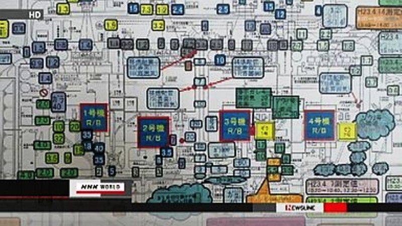

shogun338 said:
Broken pieces of fuel rods have been found outside of Reactor No. 2, and are now being covered with bulldozers, he said. The pieces may be from rods in the spent-fuel pools that were flung out by hydrogen explosions. Looks like we where right about fuel rods blown out of spent fuel pools .
Is there any new information available regarding the distribution pattern?
  • #3,298
According to whom? Please cite sources when making claims.
[PLAIN]http://k.min.us/ik74PC.JPG
http://www.nytimes.com/2011/04/09/world/asia/09japan.html?_r=2and
[PLAIN]http://k.min.us/imOrOa.JPG
"[URL Report, Official Use Only, Fukushima Assessment, March 26th, 2011
last paragraph page 13[/URL]
