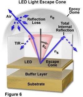

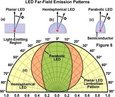

What exactly is the difference between Frensel reflection and total internal reflection with regards to the efficiency of an LED? Do they both occur at the semiconductor/ air interface? I am a bit confused, thanks for the help.
Not difference - they are related.
* Fresnel reflection: one interface reflected like a transmission line due to impedance/refractive index discontinuity
* Total internal reflection: two interfaces spaced just at the right distance to constructively reflect or cancel, where each interface has Fresnel reflection

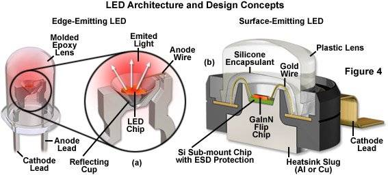

There's a interface between epoxy/plastic and air.
These lenses are designed to get the light out. :biggrin:
But they can't get it all out.
Thanks to http://zeiss-campus.magnet.fsu.edu/articles/lightsources/leds.html for the images.
