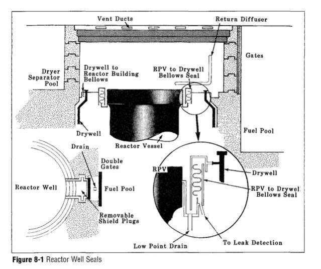

Nuceng, while we are in this area, I have a question:
I understand during refueling the reactor well is flooded and a seal exists between the RPV and DW. (IIRC, there was an accident some years back where it leaked and allowed some 200,000 gallons of water to leak into the DW.) My question is, how or if, this seal is changed, maybe a hatch or several are removed after the reactor head is installed and the well is drained but before the DW head is installed? I assume during operation the lower DW communicates with the DW head area above the reactor head?
You are correct. There are manholes in the bellows which are closed during floodup of the reactor cavity for refueling. They are opened during normal operation to permit drywell cooling to cool the area above the vessel head.

jim hardy said:
Thanks M&Mand Nuke.
Did you friend have the crane clearance on refueling floor?
One of the articles i saw today showed a generic 'to scale' drawing of shroud standing up in a GE containment, ready to be lifted and set into vessel..
There was barely clearance for crane with shroud sitting in S/D pool which is lower than refueling floor. So i think that's the bottleneck, vertical clearance to overhead crane once it's up to refueling floor.
Looked like there's plenty of clearance to roof but crane is lower than roof by at least enough for people to stand on it and clear the roof beams.
The article was by a services company that makes a special lifting ring for shroud, to accomplish that particular lift - i looked for an hour and can't find it again but will post link if do.
So it was a generic drawing , again not Fukushima . But a nice round roof beam sounds to me more likely to have been made on purpose than accident.
Oops, missed that. From the floor to the bittom of the crane support girders is 24 ft (7.3 m). The shroud would be light enough that the would use the secondary hook on the RB crane. Depending on the size of the lifting ring it might be close. There is also plenty of room on the refueling floor for a purpose built crane to do the lift if the RB crane is too low. The bottom of the roofing girders is about 40 feet above the floor (12.2 m).

thanks 7.3m - 5.18m = 6.95 ft for a lifting bar and crane hook...
tight, sure not much clearance to lift it above floor... but it might work.
Murphy wouldn't let us have a definite go-no go.
thanks!
