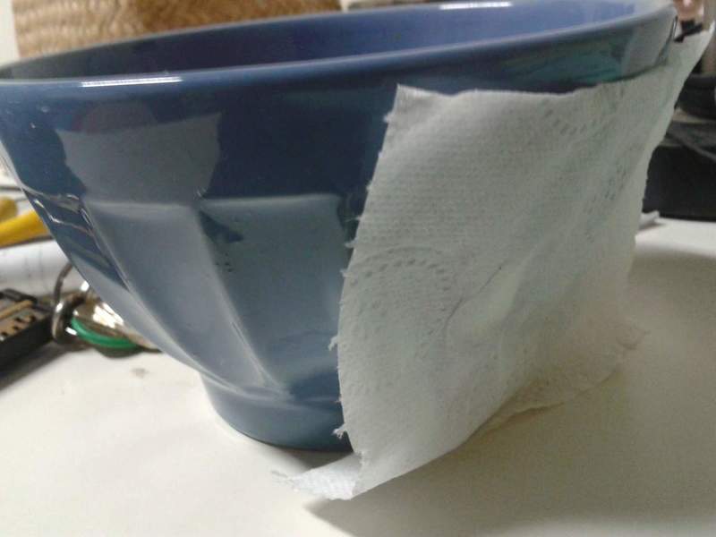

I have a bowl in my kitchen that turns black when heated (when it goes to the microwave oven or the washing machine). It is driving my crazy so I started to investigate. Here are the results:
This is how it looks after cleaning it:

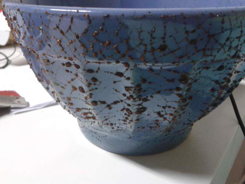

After going to the microwave it becomes like this:
Click image for larger version
Name:	2013-03-08 23.55.28.jpg
The covered part of the bowl also became dirty so the black stuff seems to come from the inside of the bowl.

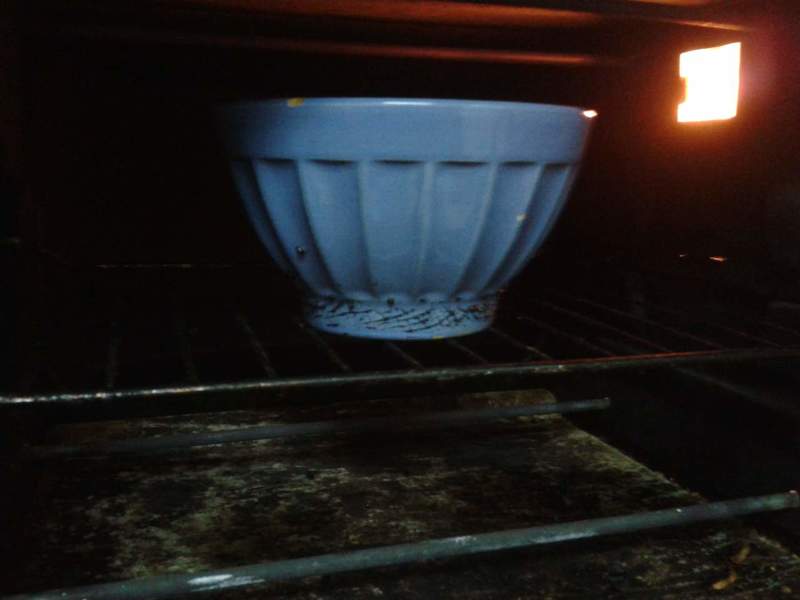

Now it started to investigate at which temperature it becomes black. I put it in the oven and set the temperature to 120º C (248º F) and nothing happed. At 150º C (302º F) the black stuff started appearing at the bottom:
Name:	2013-03-09 00.26.37.jpg
Then took the oven to 220º C (428º F) and it stayed the same.
Please help me solve this mistery! I have other bowl equal to this one that also suffers from this stange disease.

I may add that the black thing is hard and sticks well to the bowl, it is not easy to get it out. After pressing it, it sticks to your fingers.

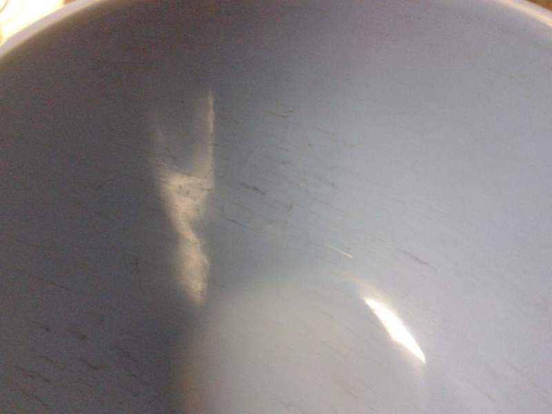

the pattern seems to be the same each time. The black stuff also appears on the inside but with less intensity:
Name:	2013-03-08 23.55.36.jpg
This picture was taken at the same time as the second picture above.
Alcohol and glycerin based soap I don't have at home. It doesn't dissolve very well on dish washing detergent. What could bleach tell me?

My bet is that the ceramic contains some partially volatile impurities, which try to escape when heated - and they escape through the cracks of the glaze. If so, it should stop after several uses.

Borek, but if it was volatile it wouldnt become stuck between the cracks, right?

Depends. It can be liquid at elevated temperatures, leak outside, and oxidize there.
Some time ago someone posted similar question and pictures, but I am not sure if it was here or at another forum. Things that they observed were different (white and fluffy), but otherwise the situation was similar - it grow on the outside of the heated ceramic vessel.

Likely a dark colored bowl with a semi-opaque coating (opaque from crystallization) or a dark pigment in a matrix of microcrystalline material. When cool the coating is highly reflective (diffuse reflectance). When heated the crystallites melt producing a clear matrix that allows light to penetrate more deeply into the coating where the light is attenuated... hence black.
