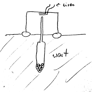

I wonder. Making a device that wil start an allarm once specific gravity gets close to the target value doesn't sound complicated.
Remember to list me on the patent application.
Sure
