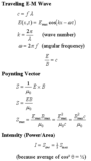

Hi! I have this homework problem that I just don't understand why it's wrong.
A monochromatic light source emits 110 W of electromagnetic power uniformly in all directions.
(a) Calculate the average electric-field energy density 3.00 m from the source.
(b) Calculate the average magnetic-field energy density at the same distance from the source.
(c) Find the wave intensity at this location.
First of all, I know that (a) and (b) will be the same. I have also calculate part (c), which is correct, and it is 0.9726 W/m^2.
I have used various equations that would work for this type of problems.
1. The Sav, or average Poynting vector, in terms of the magnetic and electric field. I always get the same answer, which is 6.4*10^-8. Then I use the energy density equation, which gives me 3*10^-9.
2. I use Sav=cu...since I have Sav, and I know c, then it seemed logical to use this. My answer is the same, 3*10^-9.
But its WRONG, and I don't understand WHY! PLEASE HELP ME.
Thankyou!

I took a bit more simplistic approach and just calculated the energy density from the rate of energy flowing through the surface (power) and the speed of light. Looks to me like the total energy density is
u = P/Ac = 3.24*10^-9 J/m³
Actually...the equations that are given in the book are very general, and none of them involve integrals.
I have used the third equatin below Poynting vector.
And I also used Saverage/c=uaverage...but it's still wrong.
I just divided the 3.24 by 2, which gave me the answer.
The reason why I did not get it, I think, is because the book does not present it correctly.
The Smax equation in the picture above is actually given as Sav in my book, so that's why the answer was not correct.
