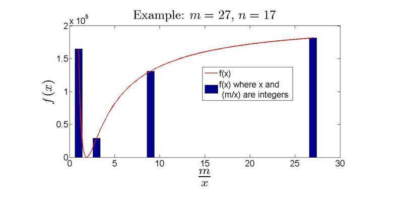

I'm not sure if I fully understand the question... I have attached a graph showing an example where the minimum value of [itex]f(x)[/itex] (where fractional/non-integer quantities are allowed) does not fall closest to the minimum allowable discrete value.
In this case, the minimum is at [itex]\frac{m}{x}=1.8865[/itex], which is closer to 1 than the optimal value 3. I could probably find more extreme failures, but the shape is generally something like this.

I was asking for the shape of f(x) (being a well-known shape), but if you know the shape of f(m/x), then that's good enough.
The broad shape of the graph is it starts at some value, it decreases until it reaches a minimum, and then increases until it reaches a final value.
So, if you know the graph has this overall shape and you know where the true minimum occurs, and you know which values of x are allowed, do you see how to combine that information?

I don't think I do. Perhaps it would be easier for me to think about [itex]f(x)[/itex] because that would be a parabola, which at least is symmetrical about the minimum...?

So in your numerical example above. Instead of solving for possible values of "x" that made 27/x as close as possible to the ideal value of 1.8865. You should instead have been solving for the value of k (where x = 27/k) such that 1/k is as close as possible to 1/1.8865. This would lead you directly to k=3 rather than k=1.
