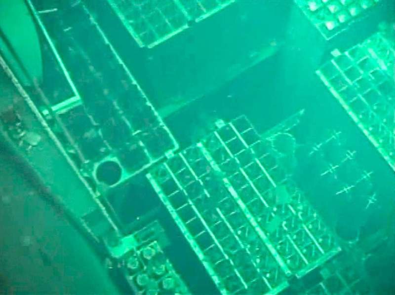

clif said:
Stacking in a SFP?
MOX燃料を真上から (Fuel from right above)
MOX would mean reactor #3
The objects on the right appear to be a level higher then those on the left.
Image from here
http://www.newcs.futaba.fukushima.jp/05-20000519/index41.html"
What that appears to be to me is two fuel racks to the right and left at the same level, but empty. In the center are two short sections consisting of two rows filled with control rods. The lifting handles of fuel bundles and control blades are different and these look like control blades to me.

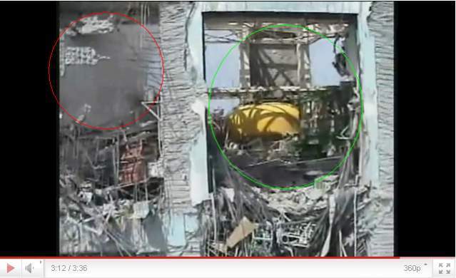

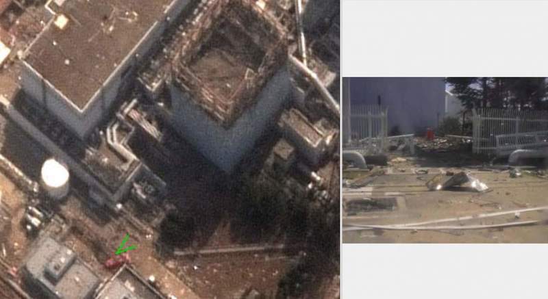

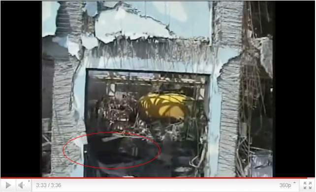

RE: THE EXPLOSIONS AND PATTERN OF DAMAGE AT BLDG 3 & 4 -- SIMILARITIES AND DIFFERNECES
@Fred:
M. Bachmeir did extensive analysis of the sound frequencies and concluded that Bang 1 and Bang 2 were similar and were explosions and that Bang 3 was fundamentally different from the first two, as I recall. Maybe he would comment again about the possibility of one of the audible bangs being a mechanical transient from a large falling object.
If FHM 3 is in the pool, (yes Fred, mea culpa, my initial scenario proposal was wrong and I do believe the FHM is mostly in the SFP), then the blast still had to be strong enough to lift it, de-rail it, and let it fall with enough force to hit and submerge completely in the pool, else part of it would have been visible above the water level. And if it is in the pool, then something either had to break or bend significantly on one or both ends for it to fit.
There is a lot of complex-looking green equipment in all of the reactor buildings, though, and fragments and various damaged parts of them are tough to identify visibly.
OBSERVATIONS ABOUT THE EXPLOSIONS AND DAMAGE PATTERNS
Whether FHM 4 is in its normal position or down by a meter or two is really less the point than that the overriding fact that the explosion at Unit 3 was much more powerful than the explosion at Unit 4. Whether it was none or part of the FHM3 that went ballistic is also not strongly relevant at this point, because, whatever it was that went ballistic, a lot of stuff did go ballistic, both vertically and horizontally, much more so at Bldg 3 than Bldg 4.
If one accepts the possible scenario of the damage at Bldg 4 being due to the asphalt roof, then it follows that the same mechanism was likely in play at Bldg 3, given a similar epicenter of the apparent explosion, over the SFP.
I am not so sure it was reinforced concrete, having red a bit last night about commercial industrial roofing. I believe the roofing material was flexible and water proof (concrete is neither), and that it was laid on corrugated metal which peeled off the roof girders, partially lifted, and then from a more vertical position, plunged into the north end of the building. Actually the analogy of the mechanics of a folding convertible car top coming up and over the interior of the car before folding back into the trunk space is a pretty good analogy, if you have ever had a convertible. Something very similar might have happened at Unit 3 with some variations.
The stronger explosion at Bldg 3 initially blew more of the roof apart and straight up. The stronger explosion more forcefully blew the more northern section of the roof higher and further back. The more northern portion of the roof, instead of crashing in a more or less large, intact slab, just into the norther end of the building as at Bldg 4, took out the north-facing upper wall completely, and much more extensively damaged the north end of Bldg 3 and the building below.
Step back and take an overall "big picture" look at the pattern of damage done to the roof and upper structures at Bldg 3 and 4. I believe that there are some pretty strong similarities in the damage patterns, except that, again, the blast at Bldg 3 was much more powerful.
Though I can offer no credible technical explanations for the "why and how" of hydrogen and steam explosion being involved at both Bldg 3 and 4, I can and do offer my revised scenario that the difference in total energy at Bldg 3 vs Bldg 4 was that of a hydrogen explosion coming from the primary containment at Bldg 3, and then, for whatever reason, to a much greater degree, the water in the SFP at 3 turning to steam than at Bldg 4, and that the visible damages were due in significant part to portions of heavy roof segments, not falling machinery.

No need to beat your self up I liked and concurred to the Balistic FHM and at the time , given the information at hand it was plausible. Now that we have the Bolt Machine, the FHM is less plausible.
I'm not so keen on the soundtrack , it may be exploited as an evidence but with it's low level I'll prefer to stay away from it until it is properly sourced, actually, this video I one of the less reliable piece of info that we have.. ( I see the face of a man in the smoke don't you ?)
"There is a lot of complex-looking green equipment .."
I think with all the pictures we have we can start counting:
unit 3
1) top crane center
3) FHM and FHM crane (somewhere initially on the south part eat middle)
3) Cast Crane south west wall
4) Bolt machine (initially on the north west center)
Could you please clarify I did not understood that scenario .. I'm probably failing at English there
  • #4,180
Yes I do... or did, was it unit 4, middle window west side?... er wall panel
I don't like the sound at all on the video, there must be somehwere to ask about the source of that video>

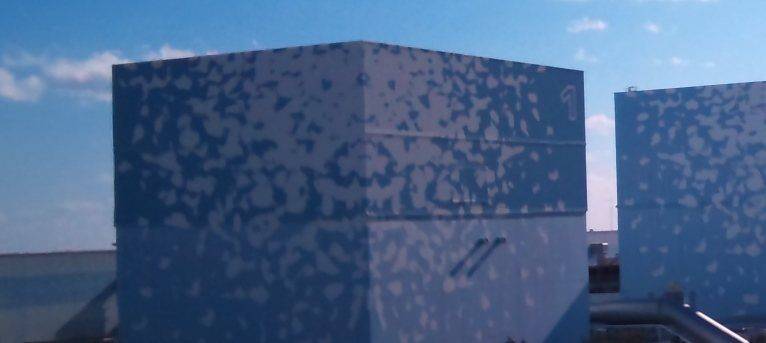

Fukushima 1 Nuclear Power Plant_38
This picture was taken at Fukushima Daiichi in 1999. More pictures available at http://www.flickr.com/photos/hige2/sets/72157626327994523/

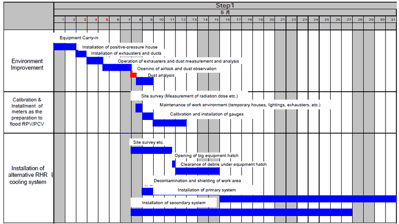

Beginning to sound promising... actual plan with numbers in!
from the new york Times:-
"Anne Lauvergeon, the chief executive of Areva, France’s nuclear power equipment provider, said at a news conference in Tokyo on Tuesday evening that it would take at least until the end of May to set up a water treatment station at the Fukushima nuclear plant and begin purifying water. Once running, the water treatment facility should be able to handle 50 metric tons of water an hour and will be able to reduce the radiation in the water by 99.9 percent to 99.99 percent.
Ms. Lauvergeon said that even having the system up by the end of May would pose a big challenge. “It is a fight against time, but we are doing everything in our power” to meet this timeline, she said. "

From the photos taken by the sampling camera, it looks as if the water in #4's SFP is hot and stirring. Could it be boiling? (The infrared pics show rather low temperatures --- but perhaps the IR camera does not have a direct view to the liquid?)
If the water is boiling, and the pool water is slightly acidic, wouldn't the iodine evaporate as I2 or HI? (I suppose that the cesium would remain in solution in any case).
Boiling doesn't mater. CsI may get attached to droplets carried off with steam but most will remain in the water. The use of seawater to keep the pools full should prevent acidic conditions in the pool.
If operators were able to get close enough to the pool to take a sample it must be well short of boiling.
If you've ever brought a large pot of water to a boil (e.g., home brewing) you see a lot of motion and stirring well before bubbles start to form. That is convection. When bubbles do start to form on the hot surfaces they may grow and break off but don't reach the surface because the bulk temperature is still below boiling. That is the onset of nucleate boiling (ONB). In a reactor when the surface reaches a high enough temperature a layer of steam covers the surface of the fuel and heat transfer is cut drastically. This dryout is the Departure from Nucleate boiling (DNB). That is the big difference between a PWR and a BWR.
PWR's have design limits to prevent ONB. BWR's worry about DNB. They don't start making money until they achieve ONB.

What were they trying to do in unit #4 before it exploded/burned and after #3 exploded? In this picture, #3 has exploded, #4 has not, but I do not see the truck halfway into the access bay where they load/unload fuel and other supplies for the building:
http://www.digitalglobe.com/downloads/featured_images/japan_earthquaketsu_fukushima_daiichi_march14_2011_dg.jpg
Am I missing it? The truck is clearly visible in all subsequent overhead pictures of #4 after it burned/exploded:
http://cryptome.org/eyeball/daiichi-npp/pict12.jpg
They didn't get close to the pool, There's a video of them using the concrete pump with a sample tube (looks like stainless steel) hanging on a wire/rope from the tip.
I also think the pool would be more of a radiation hazard than a heat/steam hazard.
