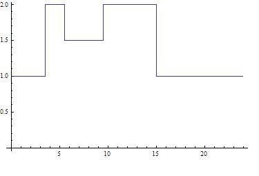

How do I define a stepwise function in Mathematica? I am trying to model the behavior of a detector up in the atmosphere. For instance, the detector might experience temperature drops in the atmosphere over a 24 hour period. I would like to know if there's any way of using a step function in Mathematica to do that. Thanks.

I actually tried to do a piecewise function but it didn't quite work out. Instead, I just plot the points and connected it so that it looks like a stepwise function. I have attached the plot I want to this post. However, I need to learn how to do achieve this shape the right way with a stepwise function and not just points, because in the future I will need to replace this function instead of a sine function into two differential equations to solve it.
The points I am using are for the attached plot are
{{0, 0}, {0, 1}, {3.5`, 1}, {3.5`, 2}, {5.5`, 2}, {5.5`, 1.5`}, {9.5`,
1.5`}, {9.5`, 2}, {15, 2}, {15, 1}, {24, 1}}
The x values are fixed. The y values can change but the same shape needs to be achieved. If this is impossible to do with a step function, is it possible to model this using a cubic spline function with the same general shape as the step function?
I would appreciate any help.

Code:
Plot[Piecewise[{{1, x < 3.5}, {2, x < 5.5}, {1.5, x < 9.5}, {2,
    x < 15}}, 1], {x, 0, 25}, PlotRange -> {0, 2}]
worked fine here (Mathematica 6.0), without the vertical lines (they finally fixed that bug :smile:).
But if you insist on the vertical lines, you can use
Code:
Plot[Which[x < 3.5, 1, x < 5.5, 2, x < 9.5, 1.5, x < 15, 2, True,
For the vertical lines, you can also use the Exclusions option:
Code:
    x < 15}}, 1], {x, 0, 25}, PlotRange -> {0, 2}, Exclusions -> None]
