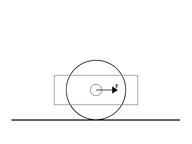

Here is a diagram. darkfrog. Main mass M has a wheel of mass m, radius R, and moment of inertia I attached to it. An external force F is applied at the center of mass of M and directly to the right.
The bearing is to be assumed frictionless. The wheels rolls without slipping and without rolling resistance.
Please, label all other force you think should be there, and find their magnitude. After that, I'll post my version, and we compare notes.
