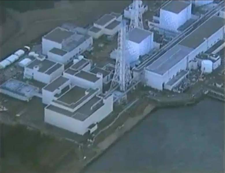

  • #3,387
NUCENG said:
Potential Root Cause: The design failure of the tsunami wall being topped by a larger than design basis tsunami became a single point of failure that made the accident inevitable.
There is no tsunami wall around the nuclear power plant I can only see a breakwater to protect the harbour and the intakes from wave action.
I still maintain that ground floor elevation of the nuclear reactors is determined by basic sizing constraints to keep the basement above sea water level.
The tsunami study of 2007 that is cited earlier in this forum and proudly presented by Tepco that it calculated a tsunami of 5.7metres for design, was an afterthought and not a original design parameter. (If they looked at historical data they should have been extremely worried since the study which they preferred to ignore) The model for the Tsunami was developed in 2002 but the reactor was built in the sixties. If Tsunami was an consideration for design back in the sixties they would have fallen back on historic records.

In the METI slides (see posting #3402) it shows a 10 meter elevation difference beween sea level and the foundation of the Turbine Building. That would allow a basement depth of 4.3 meters and it would still be at the design tsunami elevation. So you are right, but that is a distinction without a difference because the tsunami was 14+ meters and the basement was flooded.
Tsunamis, seiches, hurricane storm surges, and external flooding have been considered in reactor site licensing in the US since the 1960s. If the Japanese didn't consider tsunamis during initial plant siting and design I would be floored - after all tsunami is Japanese for harbor wave.
Once the plant was built, it is tough to move it to higher ground. If a later study indicated a bigger threat existed, it would be up to the regulators to insist on additional precautions, because plant owners might be reluctant to pay for the new work. That kind of thing has happened repeatedly here in the US. Japanese Industry/Government relationships are reputedly somewhat backwards by the US model.
