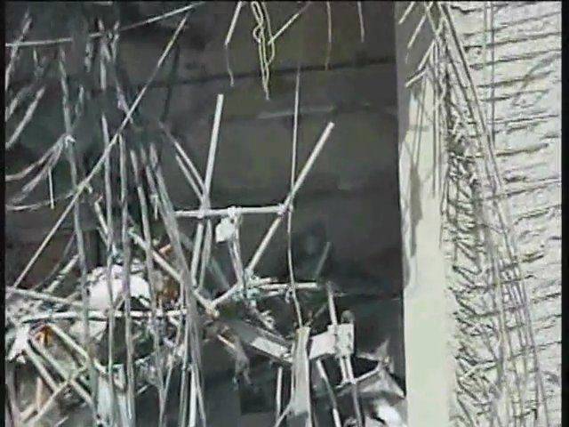

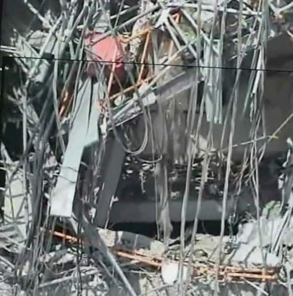

Some images just released... mostly terrible resolution!
http://cryptome.org/eyeball/daiichi-npp6/daiichi-photos6.htm
Honeywell should be embarrassed by those photos! Is that what our military has been spending money on?
