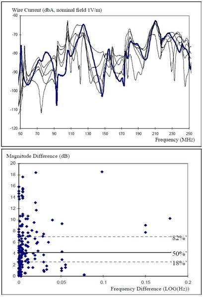

FWIW, here are some graphs from an EMC conference paper I gave many years ago, on a method for using statistical means to manage the spread of different transfer functions for 'test wires' in a simplified vehicle body shell.
What I did was develop means to automatically simulate a variety of conditions (specifically, this graphic is showing variations in transfer function for radiated angles/polarisations and wire position with the simulated body shell), and also statistical techniques for analysing both the magnitude and frequency differences (and, further, also discriminate the 'numerical errors' from the simulation method itself [FDTD was used for these simulations]).
Wires were ~0.5 to 5 x wavelength, in the frequency range simulated for.
The second graphic shows how you can then plot and inspect the range of data for mag and frequency differences, which you can use to then draw generalised conclusions about the relative immunity and transfer impedances between different harness layouts.
Now that I see these plots again, and come to think about it (this was 15 years ago!), the general 'rule-of-thumb' for the frequencies of interest in automotive (well, at the time, the spectrum of interest has gone up since then due to 1.8/2.5 GHz mobile) was 1mA/[V/m], which you can see is a 'general rule' that is actually supported by these simulations.
So, take it or leave it; 'an' answer is 1mA/[V/m]. (As mentioned, it is worth what you've just paid for it, but in any case, the issue rests on what the electronics does at the ends of the cable, not what the cable does.)
