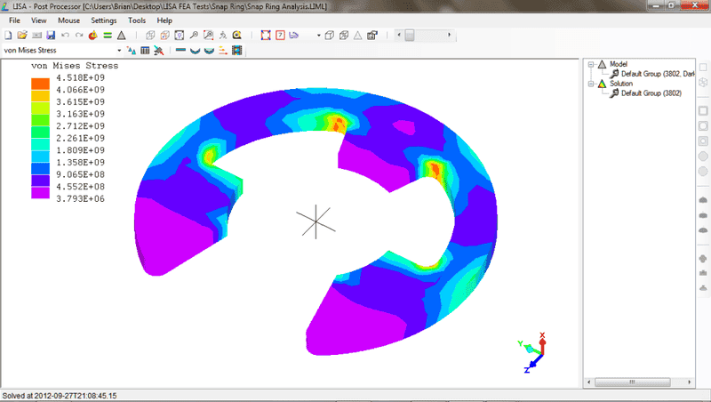

I did some messing around and was actually happy with the results, especially for the price paid :approve:

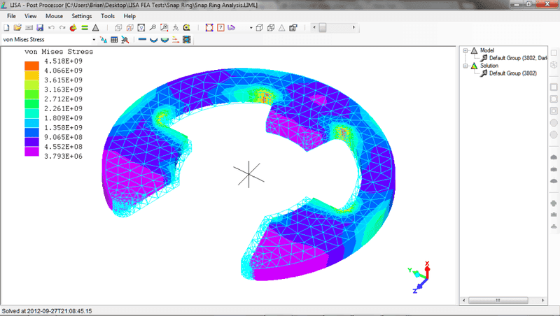

First, downloaded a simple CAD model in STEP format from McMaster-Carr (a snap ring). Here it is displayed in FreeCAD:

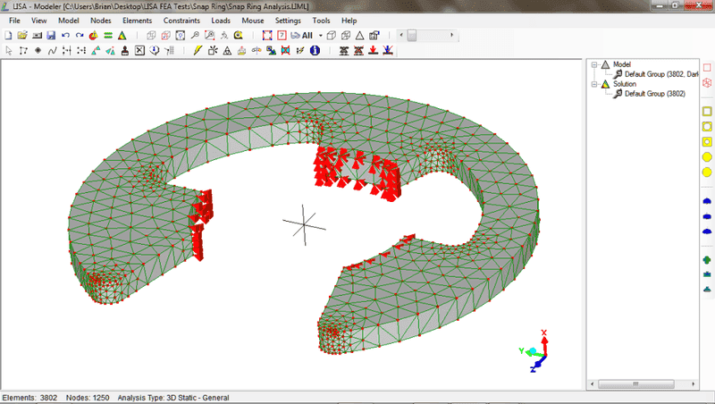

So, the question is what does it look like when LISA auto-meshes it... I was pretty happy with the result with basic default settings, and the node count was just under the limit:
Next, I applied a basic set of fixed conditions to some nodes, applied some deflections to some nodes, applied some basic "steel" peoperties, and solved it. It was pretty easy, and the result was what I would consider an expected result.
I need to gain some better understanding of the units system as I think I'm off in there somewhere, but I thought the post-processing was good, had some nice-to-have display options, and makes overall output of the results easy to visualize (even has a video animation mode).
So far, I'm liking what I'm seeing considering it's all free up to this point :biggrin: I don't currently have an imminent need for home FEA, but if I did I think I could recommend LISA for basic structural at least. The node limit for the free version is probably better suited for 2-D models, but $80 really is a steal and that would allow you to solve some simple problems that I could imagine coming up.
I was happy with LISA's auto-mesh algorithm as well, importing the c-clip was as easy as opening it and setting a max element size. It automatically refined on curves, and put together overall a nice starting mesh (although it would need some refinement to get better stress results in the corners). This could be solved by meshing just the surface of the c-clip and doing a 2-D model, which I'll see if I can get done next.

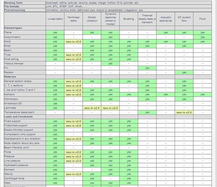

Here is a list of features shown on their website, but I haven't had time to play with it yet.

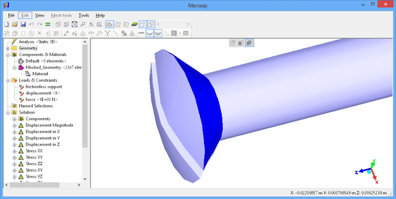

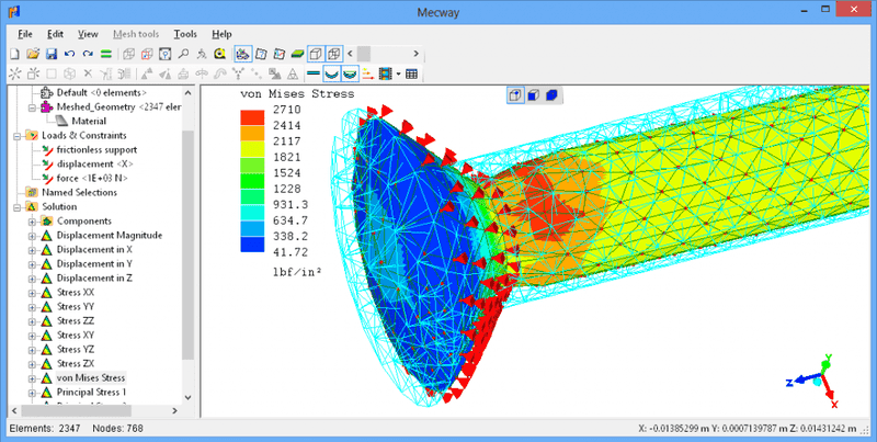

I eventually got to looking into Mecway (http://mecway.com) and I feel I should say something about it here. As a Lisa user, I have to say it's very impressive! It's clearly based on Lisa but absolutely full of enhancements even though it's the same price (both are now $100). Things just feel more comfortable. Here are some differences I noticed:
Using STEP files is easier. In Lisa, you had to scroll through a list of surfaces to find the one you want. On a complex model with hundreds of surfaces, that was sometimes very tedious checking them one by one. In Mecway you simply click on it and apply a load or whatever right there.
Everything has units of measurement now which is a real breath of fresh air. I was restricted to using pure SI in Lisa because it was "agnostic" and didn't know anything about units. But with Mecway you can make dimensions in mm and mix that with force in pounds then show the stress in psi or MPa.
Mecway doesn't seem to use named selections anymore. This is a bit tidier because when you create a force it only adds a force, not an extra named selection along with it. There are also some new loads - an interesting one is frictionless which let's a surface slide in whatever direction it's at. With Lisa you could do this in theory using rotated coordinates on every node but it would be too impractical in most cases. Here's an image of it used on a screw head. It looks like it's working as expected with the head being pulled into the cone.
I've done a bit of sheet metal work before and shell elements are essential. Mecway extends these to include buckling and dynamic analysis which would have been a lot easier than building everything from bricks like I did with Lisa. Here's an image of local buckling in a channel steel.
Other things it claims to have are a nonlinear solver and a higher limit of a million nodes which I havn't been able to test using the demo but will be fantastic since I was alway running into the brick wall of Lisa's much smaller limit (60,000?). I didn't try the nonlinear solver either.
On the downside, the meshing is still a bit rough. Sometimes it created "invalid topology" elements although instead of waiting till you solve it to discover the problem, it displays a red X on the invalid elements immediately.

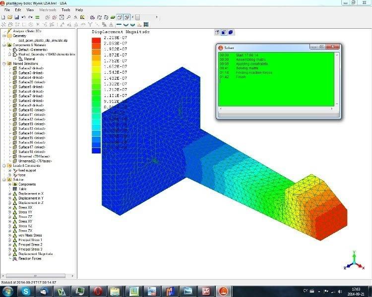

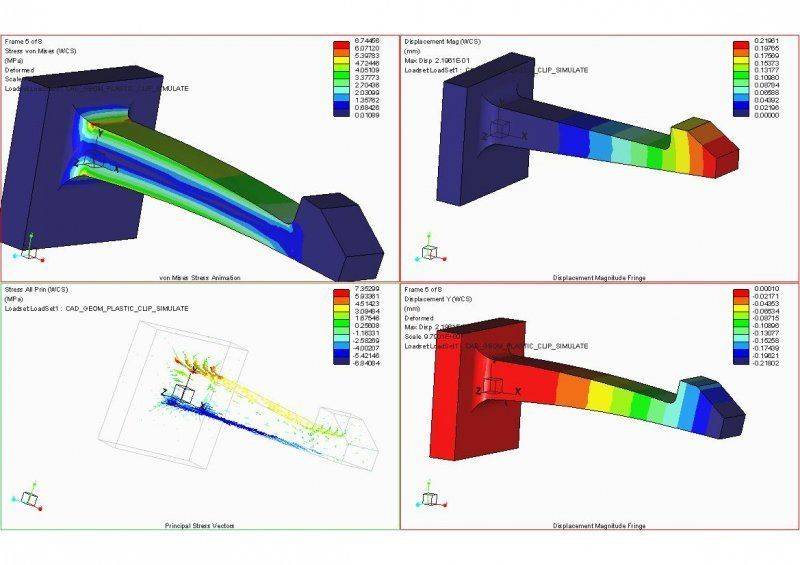

Hi Guys I have just seen this post and as I used LISA a little bit and I acquired a license for MECWAY I thought I will post few things.
Main thing is the question of the topic: Is cheap FEA soft worth anything. If you look at Calculix, Elmer, OpenFOAM, Code Aster and Saturn you will realize that YES it is and it is used by big companies, even nuclear firms are developing one and using it for civil, structural and CFD analysis.
@tioker - in LISA you can use any type of units but you have be consistent as just like doing analytical calculations, if you use wrong units in formula you will receive magnitude higher or lower results or just a scrap results. According to license LISA and Mecway are the same 100$ but just LISA allow you to use it commercially, in Mecway it's just for educational purposes or private without any commercial use, if you want one you have to spend 350$. In LISA you are able to do most of the things that on Mecway you will do , there are couple enhancements as geometrical nonlinearity, compression constraint, elastic support, stress linearization graph and few more which would be hard to perform/apply in LISA or not possible at all. I am going to do some Creo Simulate comparison with LISA/MECWAY and other software to help in learning them and FEA itself and I have already done some comparison. Simulate has got some tutorials which were done professionally so I take results as correct. Please have a look at results and compare if 100$ is worth it's price.

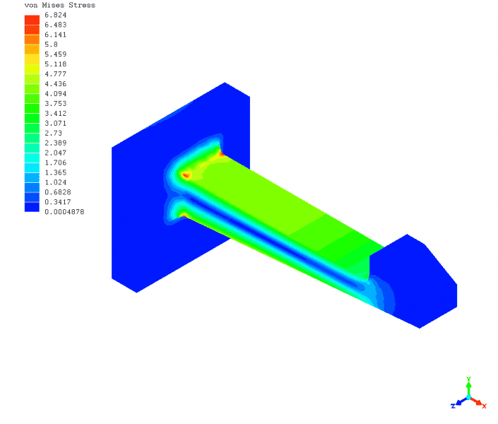

Comparison shows how close LISA and MECWAY are to Creo Simulate in this simple case with regards to stress and displacement. Creo is much more powerful and easy to apply boundary conditions but it doesn't do Flow Analysis for example and you can do it in LISA/MECWAY. Results of LISA/MECWAY were indentical, the mesh was generated identically using the same setting of course as it uses Netgen for meshing. Mecway was created by LISA's ex-programer so this is why they are identical. I like in LISA adding faces, volumes, nodes to one section and couple other things but I have to admit that Mecway wen't forward so much in ease of use and that it looks very promising. Please have a look at my website, where I used LISA for some analysis structural, fluid and thermal transient for real and theoretical applications. I intend to use it more and will try to compare its functionality with Creo Simulate as I just started to go thorough it's training. I will post in more detail comparison of LISA and Mecway to Creo and hopefully for some tough subjects which L/M are not capable to deal with eg. contact analysis I wil try to go for Calculix/Elmer or eOOS. My web page is www.arek.pajak.info.pl and of you want to have a look at some more free software please go here: http://feacompare.com/
