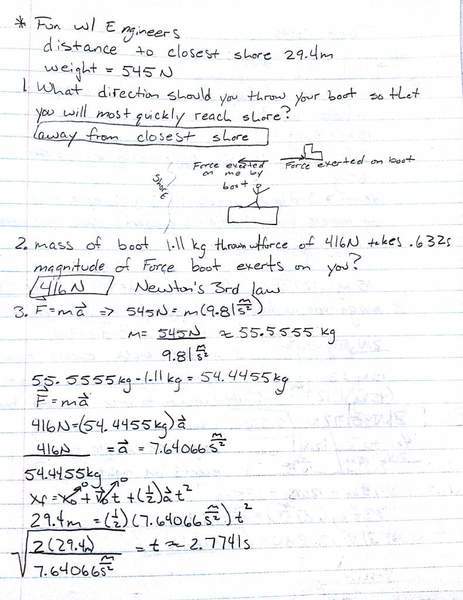

3. The attempt at a solution
I am having trouble with question 3 of this problem. I calculated the acceleration using 416 N and the mass minus the boot. I then use x = x_0 + v_0 t + (1/2) a t^2
to calculate time. The automated homework system says the answer is wrong.

You are not moving at a constant acceleration the whole distance to shore. The acceleration is only constant while you are throwing the boot. After that your velocity is constant.

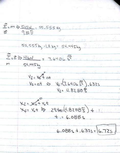

Well I tried what you said doing constant velocity but the automated homework system says the answer is still wrong.

You will cover some distance on the ice between the time that you start the throw and the time you let go of the boot. You did not account for this in your answer.
In other words, you shouldn't be using 29.4 meters the way you did in your work.

Now you are taking the whole distance travelled at a constant velocity. That's not right either. He travels part of the way while accelerating and part of it at constant velocity. It's not really clear to me that they mean you to subtract the mass of the boot either.

I agree. That "Take your weight to be 545.0 N." is a bit ambiguous. However, the parenthetical remark "(Lucky for you that, as an engineer, you sleep with your knife in your pocket and your boots on)" suggests that that 545.0 newtons includes the knife and the boots.
Aside: This is a *bad* question. I calculate that the engineer's throwing arm has to be over 90 meters long.
