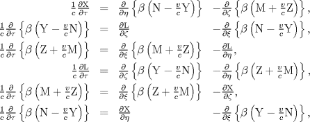

What is the simplest derivation of the transformation rules for Maxwell's equations in special relativity?
I'm working through Einstein's original 1905 paper(available here), and I'm having trouble with the section on the transformation of Maxwell's equations from rest to moving frame.
The paper proceeds as follows:
Let the Maxwell-Hertz equations for empty space hold good for the stationary system K, so that we have
where (X, Y, Z) denotes the vector of the electric force, and (L, M, N) that of the magnetic force.
If we apply to these equations the transformation developed in § 3, by referring the electromagnetic processes to the system of co-ordinates there introduced, moving with the velocity v, we obtain the equations
I do not understand just where this second set of equations comes from.
The only derivations of this transformation that I have been able to find involve either potentials, four-vectors, or both. However since four-vectors had not been invented in 1905, and because the statement of the transformation is so blunt, it seems that Einstein is using or appealing to a simpler method for finding the transformation.
So my question is: What is the simplest derivation of the transformation rules for Maxwell's equations in special relativity? Is Einstein appealing to a pre-existing Lorentz method here, or is there a trick to accomplish all of this quickly? Or does the text here simply belie the true work involved in the derivation?
They come from "the transformation developed in § 3,", one supposes.

To clarify, I'm not talking about the derivation of Lorentz transforms. I'm asking about the transformation of Maxwell's equations in special relativity. How are these derived without using 4-vectors?
I suspect the first step is to expand the derivatives in the un-transformed Maxwell equations using the chain rule for partial derivatives, e.g.
$$\frac{\partial X}{\partial t} =
\frac{\partial X}{\partial \tau} \frac{\partial \tau}{\partial t} +
\frac{\partial X}{\partial \xi} \frac{\partial \xi}{\partial t} +
\frac{\partial X}{\partial \eta} \frac{\partial \eta}{\partial t} +
\frac{\partial X}{\partial \zeta} \frac{\partial \zeta}{\partial t}$$
where derivatives like ##\partial \tau / \partial t## are calculated using the (Lorentz) transformation from section 3. Many of these derivatives are zero if we assume v is along the x-axis as Einstein appears to do. Then collect terms so as to produce the transformed equations in terms of derivatives like ##\partial X / \partial \tau##. This would be the brute-force method. There may be a more elegant method.

ObsessiveMathsFreak said:
That was the first thing I tried, but I couldn't see how it would work.
Eventually I managed to figure this out. It turn out that you do use the chain rule, but you also have to use the EM conditions to derive the result.
For the sake of making the thread a potentially useful resource, I'll give the result for the first of the equations, but I'll use primed coordinates instead of greek ones, and labeling the EM field using the usual notations. Hopefully the steps are clear for anyone reading.

To transform this, firstly we need the chain rule. Since the transformations in this case are
[tex]
\begin{align}
t' = & \gamma \left( t-\frac{v}{c^2}x \right) \\
x' = & \gamma \left( x-vt \right) \\
y' = & y \\
z' = & z
\end{align}
[/tex]
where [itex]\gamma = 1/\sqrt{1-v^2/c^2}[/itex] is the [itex]\beta[/itex] in the original paper above. It follows using the chain rule that
[tex]
\begin{align}
\frac{\partial }{\partial t}\equiv & \gamma \left( \frac{\partial }{\partial t'} - v \frac{\partial }{\partial x'}\right) \\
\frac{\partial }{\partial x}\equiv & \gamma \left( \frac{\partial }{\partial x'} - \frac{v}{c^2} \frac{\partial }{\partial t'}\right) \\
\frac{\partial }{\partial y}\equiv & \frac{\partial }{\partial y'} \\
\frac{\partial }{\partial z}\equiv & \frac{\partial }{\partial z'}
\end{align}
[/tex]
So we can just make these substitutions in the equations.
Now, before transforming the "curl" equation above, we first need to use and transform the the free space EM condition that [itex]\nabla \cdot \mathbf{E} = 0[/itex]. A representation of [itex]\frac{\partial E_x}{\partial x'}[/itex] is given using this by
[tex]
\begin{align}
&\frac{\partial E_x}{\partial x}+\frac{\partial E_y}{\partial y}+\frac{\partial E_z}{\partial z}=0\\
&\gamma \left( \frac{\partial E_x}{\partial x'}-\frac{v}{c^2}\frac{\partial E_x}{\partial t'} \right)+\frac{\partial E_y}{\partial y'}+\frac{\partial E_z}{\partial z'} =0 \\
\Rightarrow &\frac{\partial E_x}{\partial x'}=\frac{-1}{\gamma} \left( \frac{\partial E_y}{\partial y'}+\frac{\partial E_z}{\partial z'} \right)+\frac{v}{c^2}\frac{\partial E_x}{\partial t'}
\end{align}
[/tex]
This step gives us what we need. Now applying both the chain rules and this result to the curl equation gives
[tex]
\begin{align}
\frac{\gamma}{c} \left( \frac{\partial E_x}{\partial t'} - v \frac{\partial E_x}{\partial x'}\right)=& \frac{\partial B_z}{\partial y}-\frac{\partial B_y}{\partial z} \\
\frac{\gamma}{c} \left( \left( 1+\frac{v^2}{c^2} \right)\frac{\partial E_x}{\partial x'} + \frac{v}{\gamma} \left( \frac{\partial E_y}{\partial y'}+\frac{\partial E_z}{\partial z'} \right) \right)=& \frac{\partial B_z}{\partial y}-\frac{\partial B_y}{\partial z}
\end{align}
[/tex]
And since [itex]1- v^2/c^2=1/\gamma^2[/itex], it follows that
[tex]
\frac{1}{c}\frac{\partial E_x}{\partial t'}= \gamma \frac{\partial }{\partial y'} \left[ B_z - \frac{v}{c}E_y \right] - \gamma \frac{\partial }{\partial z'} \left[ B_y + \frac{v}{c}E_z \right]
[/tex]
which is what was required. For one equation at least; I imagine the other three are fall out the same.
When transforming the first equation of the untransformed set, I think you also need to take into account Gauss's Law for the electric field (in empty space), which in Einstein's notation reads:
$$\frac {\partial X}{\partial x} + \frac {\partial Y}{\partial y} + \frac {\partial Z}{\partial z} = 0$$
Transform the derivatives similarly, and combine the result with what you get from transforming the first equation. I've done enough of the algebra to convince myself that you get the correct derivatives in the final equation, but I haven't nailed down all the constants.
For some of the equations, you probably need to use Gauss's Law for magnetism instead.
I spent half an hour composing a reply showing some of the equations explicitly. Then I lost it all when I hit a wrong key, and I'm in no mood to do it all again. :grumpy:
(Aha, you posted your reply while I was going through all that! It looks like we hit upon the same solution.)

Gaba gaba, there appear to be some typos in the part you're asking about:
\begin{align}
\end{align}
[tex]
[/tex]
The first line is just the x component of the equality in this quote:
In Gaussian units, the first component of [itex]\nabla \times \mathbf{B} =\frac{1}{c}\frac{\partial \mathbf{E}}{\partial t} [/itex] is explicitly
To get from the first line to the second, he's just using the result in this quote to rewrite the second term in the first line:
\begin{align}
\end{align}
The second line appears to contain two typos. I think it should be
$$\frac{\gamma}{c} \left( \left( 1-\frac{v^2}{c^2} \right)\frac{\partial E_x}{\partial t'} + \frac{v}{\gamma} \left( \frac{\partial E_y}{\partial y'}+\frac{\partial E_z}{\partial z'} \right) \right)= \frac{\partial B_z}{\partial y}-\frac{\partial B_y}{\partial z}$$ Then he's using the equality in this quote to rewrite the left-hand side of the first line:
And he "applies the chain rule" by using these two results to rewrite the right-hand side of the second line:

So he ends up with this:
[tex]
[/tex]
