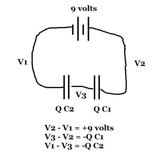

Mar2-13, 12:10 PM   #21
Mentor
Blog Entries: 1
Just to be clear, here's an example:
Imagine three identical capacitors hooked up in series. The entire string is attached to a 9 volt battery. Once they are fully charged, each capacitor will have a potential difference of 3 volts.
If the three capacitors were not the same, then the voltage across each would not be equal. But the total voltage across all three must still add up to 9 V.
Make sense?

Mar2-13, 01:03 PM   #24
Quote by Bashyboy View Post
Oh, okay, I see. The impression that I was getting from my textbooks was that the electric potential HAD to drop because of the series configuration. But now I know that isn't true. Thank you, everyone.
This might be a confusion of terminology. Let's make this explicit:
In this picture, we have a 9 volt battery connected in series with two capacitors. The voltage drop--that is, the change in voltage--across the first capacitor is [itex]Q C_1[/itex]. The voltage drop across the second capacitor is [itex]Q C_2[/itex]. If the capacitors are identical, then these two voltage drops are equal. But that doesn't mean that the voltages are equal. The voltage at the positive plate of the first capacitor is [itex]V_2[/itex]. The voltage on the negative plate of the first capacitor is [itex]V_3[/itex]. The voltage on the positive plate of the second capacitor is [itex]V_3[/itex]. The voltage on the negative plate of the second capacitor is [itex]V_1[/itex]. If [itex]C_1 = C_2[/itex], then we would have:
[itex]V_3 - V_2 = V_1 - V_3[/itex]
The voltage drops would be the same.
