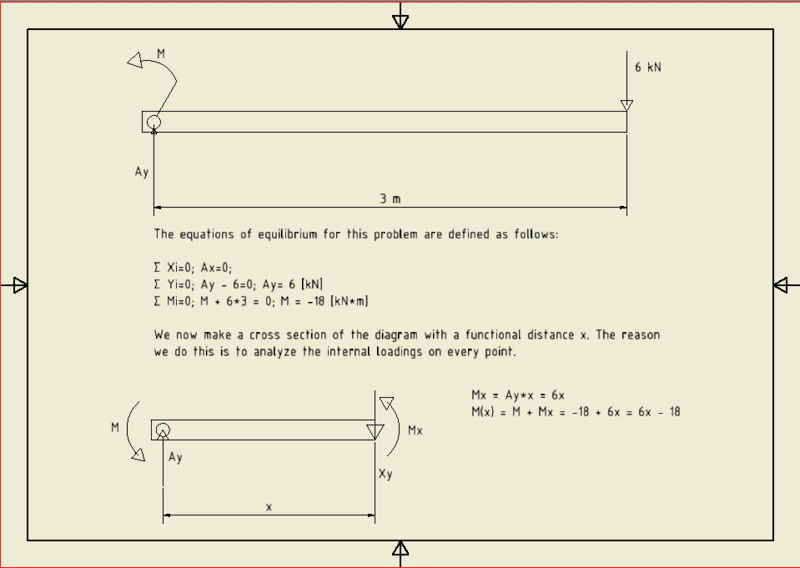

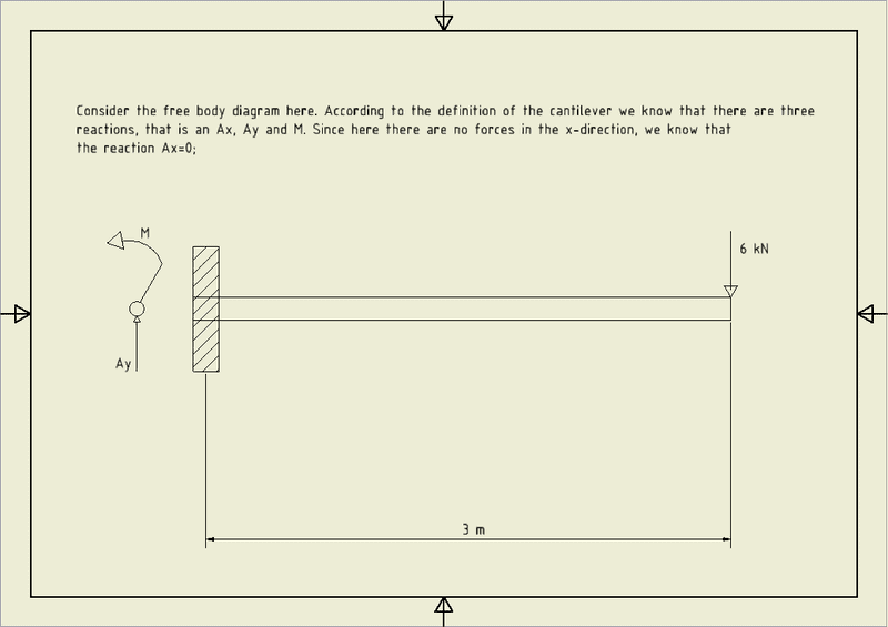

I have tried my best to sketch the diagrams so you can understand. Refer to the 1st picture and you will see that since there are no forces in the X direction, reaction from the wall will only give an Ay. You have already solved this in your problem.
Now, logically the wall will also give you a moment reaction as I said before to ensure that the constrained point does not rotate.
Now please refer to the 2nd picture and you will see that I have derived the equations of equilibrium for this problem. I have taken M as a positive moment because it is an arbitrary selection. You could take M as a negative moment and then you would get a positive scalar, that is M=18.
Now, the reason we want to do the cross-section cut is to have a mathematical equation which gives us a moment for every point on the beam. We continue with the standard as you can read on Hibbelers, Chapter 7. Refer to picture Fig. 7-1 if you have Twelfth Eidition. The cross section allows us to derive an equation for the bendind moment and that defines for any distance 'x' in the beam.

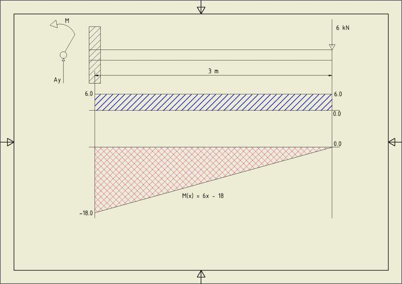

Finally please refer to the 3rd picture in which you can see that the static diagrams are drawn. Since the shear forces are constant - that is T(x) = c; we can conclude that the M(x) will be a linear equation. That is from calculus:
M = ∫Tdx
Since your equation T(x)=6
We apply the integral, M(x) = ∫6dx = 6x+c1
Since we already have c1 = -18 from the equilibrium equations we can conclude that the moment equation is satisfied M(x)=6x-18.
This is again proven by the fact that a x=0 means the distance from point A is zero therefore the moment is equal to -18. M(0)=-18 which is in agreement with the derived M from the equations.

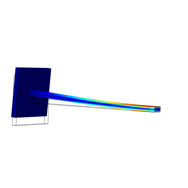

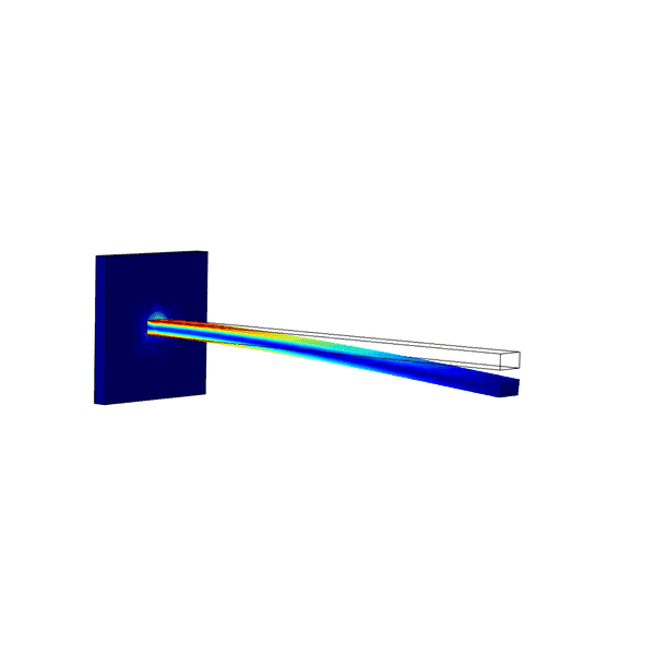

Please also refer to the two pictures below which I have created to further explain your problem. As I have said there must be no movement of on the wall side so in picture 1 you have what is the correct solution.
In picture 2 you have the opposite of the correct - and that is exactly what the wall prevents the beam from doing. Imagine a beam being able to lift the whole wall like that - not good engineering there.
I hope my explanations have been at least a bit of help to you. Please feel free to ask any questions you might have regarding the problem.
