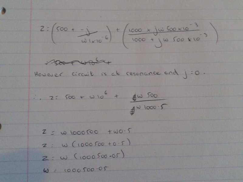

Hey NascentOxygen,
I havn't got a clue where to start I'm sorry.
This is what I've managed so far.
j is not zero; j is the square root of -1. What is zero at resonance is the imaginary term of the impedance.
You've got the correct approach for determining the impedance. What you need to do is separate it into its real and imaginary parts; write it in the form: [real part] + j[imaginary part], and then deal with finding a value for ω that makes [imaginary part] zero.
