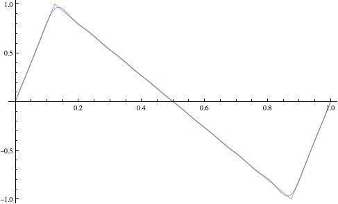

Fourie analysis for a boost converter
Where d = duty cycle, A = amplitude and t = time
Fx = (2At/d) for 0<t<d/2, -A+(2A/(1-d))*(1-t-d/2) for d/2<t<(1-d/2); (2A/d)*(t-1) for 1-d/2 <t<1.
My solution is kind off large, I need need another solution to compare my ans with before writing a script to execute this function.
I recast your problem slightly and got a pretty compact answer. Instead of working with the interval [0,1], I used the interval [-π,π], took advantage of the fact it is an odd function, and got
[tex]f(x) = \sum_{n=1}^\infty \frac{2A\sin{n\pi d}}{d(1-d)n^2\pi^2}\sin nt[/tex]
Your d might be my 1-d and vice versa, and you can rescale t by a factor of 2π to get back to your original function.

I'm assuming the function you gave in your original post is the correct one as the one expressed on the spreadsheet has apparent mistakes in the intervals for t.
I've attached a plot of your original function and the series I found (10 terms and with t appropriately rescaled). I used A=1 and d=1/4 for this particular plot. They look the same to me.
