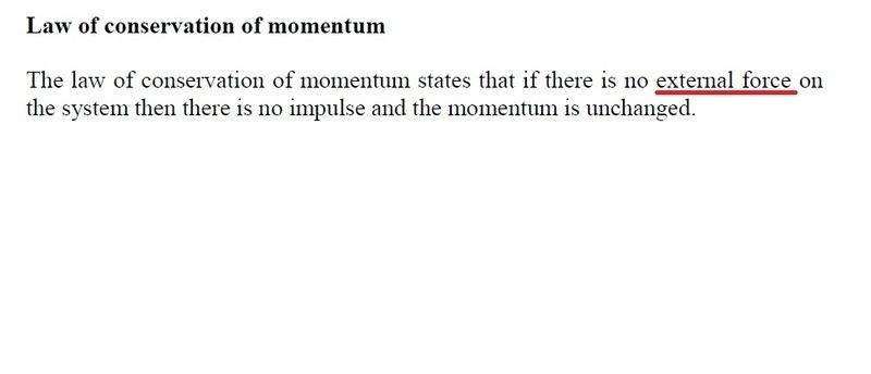

I am confused over the law of conservation of momentum.

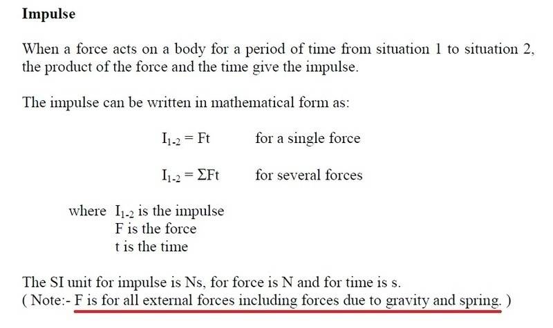

The definition says that "if there is no external force on the system then there is no impulse and the momentum is unchanged"
However under the definition of Impulse Note "F is for all external forces including forces due to gravity and spring"
So what exactly is the external force they are referring to for the law of conservation of momentum?

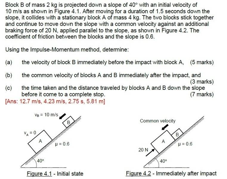

Jul24-12, 08:04 AM   #9
I would like to ask since the law of conservation says that if there is no external force on the system then there is no impulse and the momentum is unchanged.
But how come for part b of the question (screenshot attached below) the impulse = 0?
There is frictional and gravitational force, so how come it's 0? So what is the "no external force" the book is talking about?
And if you see under the impulse definition there is a note "F is for all external forces including forces due to gravity and spring"
Then once again can you explain to me what is the no "external force" under the law of conservation please...

Quote by freshbox View Post
Often collisions are treated using the so-called 'impulse approximation': Assume that the collision is of such short duration and that the contact forces are large enough so that the effect of other forces (gravity and friction, in this case) can be neglected during the collision.
Jul25-12, 03:50 AM   #11
I see. Is it right for me to say that if I see any question involving collision between 2 object, impulse=0.
Or is there any other special circumstances whereby when 2 objects collide together, impulse is not 0?
Thank you.
In most collision problems, that's a reasonable assumption. That the net impulse on the system is zero during the collision.
Is there any situation whereby 2 object collide with each other and the impulse is not 0?
You posted just such a situation a while ago: The package being dropped onto the flat car. You could think of that as a collision problem where the 'collision' is slow enough that friction has time to act.
It should be clear from the context whether the 'impulse approximation' is warranted. It usually is.
