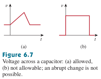

In summary, when connecting a capacitor to a DC battery of 10 volts, there is a constant voltage of 10V across the capacitor. When removing the wire connecting the battery, the voltage at the capacitor remains unchanged at 10V due to the lack of a closed loop to discharge it. In diagram A, the derivative of voltage is not defined at one point, but this does not cause any special behavior. The equation for capacitor current, i=C*dV/dt, shows that current is proportional to the rate of voltage change. If voltage is kept constant, no current will flow. The current curve is different from the voltage curve. At the black circle, there is no change in voltage and therefore no current flows. The behavior of
ainster31
158
What happens if I connect a capacitor to a DC battery of 10 volts? At this point, there is a constant voltage across the capacitor of 10V, right? Now what happens if I remove the wire connecting the battery to the capacitor? Isn't that an abrupt change of voltage because it drops from 10V to 0V?
Also, from diagram A, I notice that while voltage is continuous, the derivative of the voltage is not defined at one point. I know that the equation of the current is:
$$i=C\cdot \frac { dv }{ dt }$$
So what happens to the current in that instant where the derivative of voltage w.r.t. time is not defined (i.e. at the top of the corner)? Would current be undefined? Is that physically possible?
The infinite amount of current will need to flow if we have abrupt change in voltage.

So diagram A is not allowed? Textbook error?
No, diagram B is not allowed.

But I was referring to diagram A in that second part of the question:

Capacitor current is proportional the rate of voltage change across it (proportional to how quickly the voltage across capacitor is changing).
The faster the voltage change (frequency of a AC signal is high) the large the current flow through capacitor (short at high frequencies).
I = C*dV/dt
This means that to sustain current through a capacitor the applied voltage must change. The more rapidly voltage changes the larger the current. On the other hand if voltage is kept constant no current will flow no matter how large the voltage.
Likewise if the current through a capacitor is found to be zero, this means that the voltage across it must be constant, not necessarily zero.
Diagram B is allowed as long as you say it's "not allowed". The textbook clearly states "not allowed".
C*dv/dt=it describes the current in any case of a AC voltage across a capacitor. It even describes the current in DC. However, it does not describe intial transient for DC...only steady state DC. Whereas in AC...Cdv/dt will describe any transient.
There is where one of a physics theory guys could help a bit with some theory because Cdv/dt=it doesn't help the begginer grasp the situation very well.

I understand what happens when voltage is either constant or is changing or at least I think I understand this. However, what happens if voltage is neither constant nor changing?
Take the voltage at the black circle:
The voltage is not constant nor changing because the derivative of the voltage with respect to time at that instant is undefined.
If there is no change in VOLTAGE...then there is ZERO current just like Cdv/dt=it suggests at that exact instance. Remember, the current curve is way different than the voltage curve.
For an exercise, sketch the current at every point in the graph you show. The first part and last part of the graph (flat line) also will display the same behavior as the paragraph above.
Nothing special happened at that point. At the beginning we charge capacitor from constant current source and this is why we have a positive slope (ramp up). After some time (at the black circle) we change the the current direction, and now we start discharging phase. And this is why the voltage across capacitor ramp down.

Mathematically, there's nothing disturbing about the derivative of a piecewise linear function being undefined at certain points. What you have to be careful about is how you relate that to practical circuits.
In practice, your capacitor, connecting wires etc., will have a small amount of parasitic inductance, which means the current through your capacitor cannot be discontinuous. It follows that it's physically impossible to have the kind of voltage waveform graphed in (a) across your capacitor.
It doesn't matter, as long as the time derivative is not infinite. All that's necessary is for the function to be continuous (i.e. no instant changes of Voltage). Nothing strange will happen to the current at the apex in graph a. Any Inductance will tend to alter the details of the actual voltage / time curve but, as with all circuit realisations, the graph can be made to follow graph a within any specified limits. I assume you are trying to relate this to real life.

Summary:
Waveform A could be produced if you could switch instantly from a positive current to a negative current. To the extent that you cannot do that, the waveform would be different. Inductance makes that difficult.
Waveform B could be produced if you could generate an infinite current spike of the proper energy.
See http://en.wikipedia.org/wiki/Dirac_delta_function for the mathematical representation. Several things make that difficult.
When you connect an ideal capacitor to the supply, it will appear as a short. To the extent that the supply has a current limit, there will be a slope to the resulting voltage rise. When you disconnect the capacitor, the voltage across the capacitor remains where it was when disconnected.
Electric charge is measured in coulombs. 1 coulomb = 6.24×1018 electrons.
Electric current is the flow of charge. 1 amp = 1 coulomb per second.
Capacitance is defined and measured as the ratio of charge to voltage, C = q / v.
The voltage on a capacitor is proportional to the charge in the capacitor, v = q / C.
The charge in a capacitor is the integral of the current over time.
The voltage on a capacitor will therefore ramp up or down depending on the current flowing.
An integral cannot have an instant step change because the current cannot be infinite.
There are tricks using switches that can make it look like there are step changes. If several capacitors are charged in parallel, then suddenly switched into series, there will be a step change in voltage across the circuit, but no capacitor will instantly change it's charge or it's voltage.
