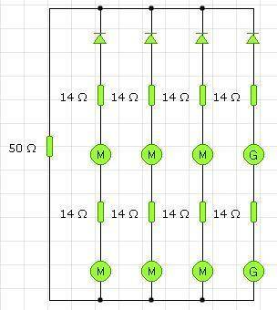

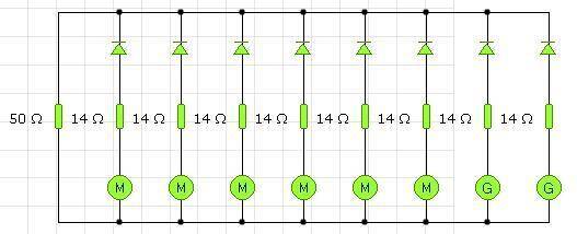

Suppose each generator can prodcue the emf with 2V.
Which circuit design below would be better for maximizing the power output of 50 ohms??
Each two generators are placed in four different directions. (i.e. East, South, West, North)
Only one side of generators are operated at a time, the rest will consume power if all generators are connected in series...
Therefore, apart from putting a diode, is there any better solution to avoid current passing through other motors(not operating generators)??
Circuit 1
Circuit 2

The second circuit would produce 30 mA into the 50 ohm load (1.5 V+ 1.5 V- 0.6 V(diode)) / (50 + 28 ohms) = 30.7 mA, so it is a little better than before.

Since the wind is artificially produced by eight fans outside a square, each side have two fans. (East, South, West, North). Each time only one side of the two fans are switched on. So in order to capture the maximum amount of wind energy, I can only place them face to each fan with the least distance allowed. However, as they are facing with 4 directions, it is difficult to let them work at the same time...any suggestion for the circuit design?
By the way, in order to measure the internal resistance of motor/generator, is it accurate to measure it by just connecting the two terminals with multimeter?
The brush contact resistance will vary when the motor is turning, but just measuring the resistance with a multimeter is good enough for this purpose.
You can get some improvement by using Schottky diodes. In the single generator parallel case, the current in the load went from 14 mA to 22 mA just by changing to Schottky diodes (from Silicon diodes). I used 1N5817 diodes in a simulation.
With two generators in series and one diode, the current in the load goes from 28 mA to 35 mA by using a Schottky diode.
I tried using saturated Silicon transistors, but I couldn't get as low a voltage drop as using Schottky diodes. This is where you connect a small resistor between collector and base and then connect the positive voltage to the collector and take the output from the emitter.
