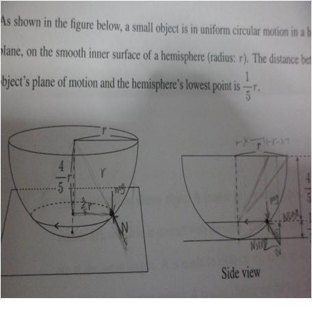

1. The problem statement, all variables and given/known data
As shown in attached figure, a small object is in uniform circular motion in a horizontal plane, on the smooth of a hemisphere (radius:r). The distance between the object's plane of motion and the hemisphere's lowest point is [itex]\frac{r}{5}[/itex]
What is the speed of the object?
2. Relevant equations
ƩF=[itex]\frac{mv2}{r}[/itex] ....(1)
Ncosθ=mg ...(2)
3. The attempt at a solution
From (1)
and I get ƩF from FBD wrote in attached figure ƩF=Nsinθ
From (2) I knew that N=[itex]\frac{mg}{cosθ}[/itex] ..(3)
substitute (3) in (1) in got gtanθ=[itex]\frac{v2}{r}[/itex] ..(4)
and I try to find tanθ from geometric of hemisphere
First, I try to find the radius (let it is r') of this mass at r/5 from the lowest point of hemisphere
If I look in the picture and use pythagoras r' = (r2-([itex]\frac{4r}{5}[/itex]))1/2
∴r' = [itex]\frac{3r}{5}[/itex]
Thus; tanθ = 3
substitute in (4) v = √3gr
but the answer is [itex]\frac{3√5gr}{10}[/itex].......
Or I get tanθ wrong or use wrong geometric condition of hemisphere ???
help is appreciate

Your tanθ should be equal to (3/5)r/(4/5)r=3/4
tanθ=v2/r'g
v2=3/4x3/5rg=3/4x3/5grx5/5=3.3.5gr/4.5.5

Oh!!! thanks azizlwl
i get it this is an easy one but i can't notice
