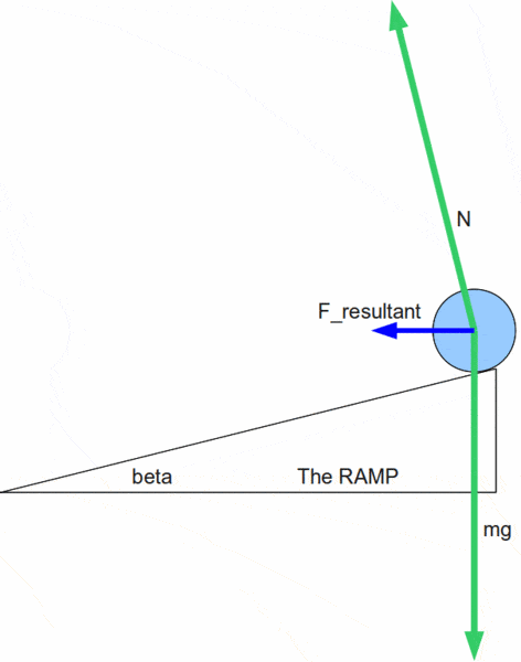

At what angle should the roadway on a curve with a 50 m radius be banked to allow cars to negotiate the curve at 12 m/s even if the roadway is frictionless?

β=arctan(v^2/r*g)
im using β=arctan(v^2/r*g) but the key says the answer is b?
can anyone help me figure out why its not 16.4??
Why not try to derive the formula?
i did...i though of the triangle as if the gravity was pointing downward the centripetal force outward and then the angle should be the same as the angle for the curve right?
If your acceleration is towards the centre the force will be too. You need to find the angle of the road that gives a normal force with the horizontal component equal to the force needed to keep the circular motion described by v = 12 m/s and r = 50m
I'm aware that my response is a mouthful :smile:, feel free to ask me for clarification.
do you mean like a triangle with the vertical 9.81*m and the horizontal (12^2/50)*m ??

Yes. But the horizontal component will be a fraction of the normal force, which depends on the angle.

I derived the same formula as you have.
When I fill in the values I also get 16.4 degrees.
So I believe your answer is correct (assuming you did not make a typo).

Here's my interpretation of the forces.
We have:
[tex]F_{resultant} = {m v^2 \over r}[/tex]
[tex]\tan \beta = {F_{resultant} \over m g }[/tex]
The OP's formula follows from this.

16.4° is correct, the answer key is wrong. It happens quite often.

Oooh I see where I went wrong. My apologies to all. I just always have trouble with the normal force being more than gravity. Its very unintuitive to me.
