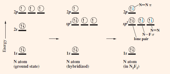

Hi, acutally I came to the conclusion that my previous statement might not be true afterall, because I found the following example in which no promotion occurs and still hybridization takes place:
Does this mean promotion does not have to occur for hybridization?
