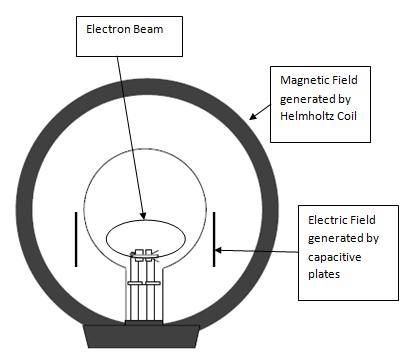

HI all, I have been trying to calculate the displacement of an electron when subjected electric and magnetic field, please see the pic below:
I anticipate that the electron will form an ellipse shape. Basically I would like to know how to calculate the major and minor axis of the ellipse.
I know how to calculate the electrostatic deflection of an electron beam, and I know how to calculate the magnetic deflection of an electron beam. I am guessing you got to combine these two ideas, but I can't figure out how. Hopefully there are some more intelligent people in here than me.
I thank you in advance
Jon

You start with lorentz force law. Your setup has created an electric field perpendicular to the magnetic field. You can create a coordinate system to align one coordinate to magnetic field, and one to electric field. It takes some knowledge of solving differential equations to get the solution, but it is possible.
What you will find is that the electron does not get back to where it started. Its path does not form an ellipse. The loop it forms without the electric field in effect drifts perpendicular to the electric field: http://en.wikipedia.org/wiki/Guiding_center

Actually not. The Lorentz v x B force is always perpendicular to the velocity, so the electron beam goes in a circle. There is no force parallel to the velocity, so no work is done and the beam does not lose energy. See thumbnail photo of electron beam in a Helmholtz coil.

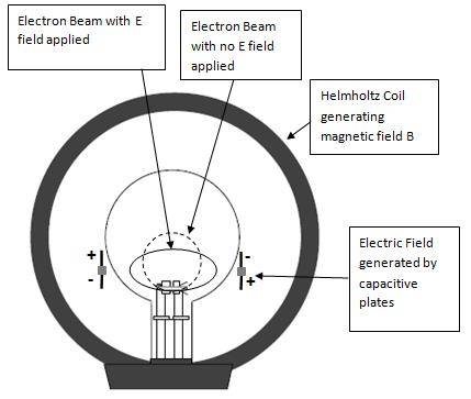

However I do not want to create a moving spiral. I want to create an stationary ellipse using magnetic and electric fields. I have come to the conclusion that in order to do this you need to use the following configuration:
Any ideas on how to calculate this? :yuck:Eternally grateful Jon

Here is the solution with the electron source (filament) in the center of the positive anode structure, which is the same as a magnetron with a radial electric field and an axial magnetic field. See
http://books.google.com/books?id=ZM...k_result&ct=result&resnum=6&ved=0CDAQ6AEwBTge
Study equations 9.80 through 9.92. Are you proposing opposite polarity dc voltages on each end of each electrode plate?
Bob S
Thank you Bob, much appreciated, I will study the equations this weekend. Yes I am proposing opposite polarity DC on each end of the electrode plates, the little grey block separating them will be a high voltage insulator. You need this configuration in order to form an ellipse, and that is what I need an ellipse.

Your proposal to have opposite polarity on each end of each electrode may solve the E x B drift problem. The direction of the drift is in the plane of your illustration (perpendicular to B), and in the vertical direction (perpendicular to E). I have not convinced myself yet that the particle moves toward or away from the center though. The orbit certainly will not be an ellipse.
Bob S
I think it will be ellipse, if you think about it the electron picks up no net electron volts.
At the major axis extremity, the electron velocity will be at its maximum. At the minor axis extremity the electron will be at its lowest velocity but will be at its maximum acceleration.
Why do think, the shape won't be an ellipse?
