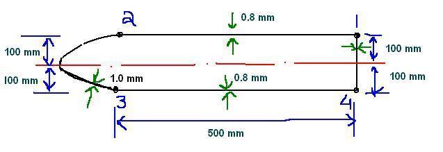

Figure shows the cross section of a single cell, thin walled
beam with the horizontal axis of symmetry. The direct stresses are carried
by the booms B1 to B4, while the walls are effective only in carrying shear
stresses. Assuming that the basic theory of bending is applicable, calculate
the position of the shear center S. The shear modulus G is the same for all walls.
Cell Area = 135000 mm^2
Boom Areas B1 = B4 = 450 mm^2, B2 = B3 = 550 mm^2
Wall Length(mm) Thickness(mm)
12,34 500 0.8
23 580 1.0
41 200 1.2
Ans: 197.2 mm from vertical through booms 2 and 3.

I recently asked the above mentioned question on this forum...
I have figured out the answer myself to this question... So iam posting the way to solve this problem so it might be helpful to anyone who is having trouble solving it...
First of all see that the shear center S lies on the horizontal axis of symmetry, the x axis. Therefore what we have to do is to apply an arbitrary shear load Sy through S. The internal shear flow distribution is given by eq. 9.80 (aircraft structure, thg megson). and since we have
Ixy = 0
Sx =0
and tD=0
Calculate Ixx.
Calculate qb23, qb34, qb41
note that qb23 = 0
The value of the shear flow at the cut is obtained by using eq. 9.47 .
Calculate qs,0
Now take moments about O we have,
SyEs = 2x0.61x10^-3Syx500x100 + 2.86x10^-3Syx200x500
Solve this, we have
Es = 197.2 mm
