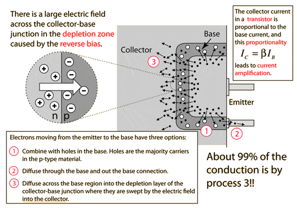

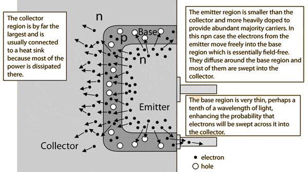

Now for transistors. Here are a couple of images that I feel are good references.
http://hyperphysics.phy-astr.gsu.edu/hbase/solids/trans2.html"
Enjoy
