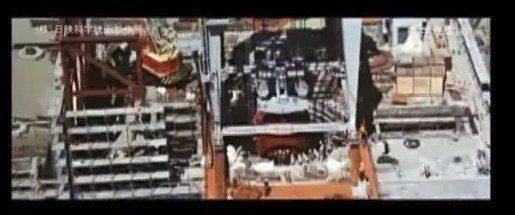

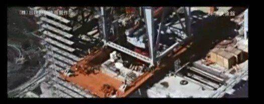

Thats what I was thinking about fuel running out . I think the guard rails around the spent fuel pools are covered in a green fabric or plastic . If you look in Unit 4 where there pumping water you can still see part of it below the FHM . The pic posted of it before the accident also shows green covered rails .
Then the paint has peeled off during the steam build up/explosion from SNP of number 4. And yes, those are fuel assemblies (what's left of them) that can be seen from the footage with the camera strapped to the concrete pump.
I'll check my archive to bring you the construction of Fukushima Daichi during the 1970s - blast from the past.
Fuel Assemblies in use at these reactors are not silvery grey, but black in colour.
Added: http://www.youtube.com/watch?v=cTshYXmN1AY&feature=mfu_in_order&list=UL at mark 1:10.
Unit 4, March 20th. What's your guess as to the temperatures we might be seeing here?
See pics of reactor room and spent fuel pool in post #2650 . Where did you get the fuel assemblies are black ?

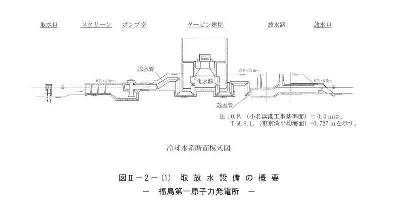

Adding to my previous speculation on whether the cooling water injected actually goes into the core as desired:
does anybody have an idea whether it would be possible to inject water into the core through the control rod drive mechanism pipes in the BWR3/4 reactors? In the ASEA BWR:s, there is a constant rinse flow of the order of 10 kg/s during operation in order to keep crud away from the drive mechanisms, and in case of emergency, this route could in principle be used to drive water into the core from below. I've heard that in some new BWR designs this injection route is considered as a possible diverse system for the high pressure core injection.
Injection via the CRD's is one of the routes that the NRC was recommending
"4. CRD injection is desired for cooling directly to the core and for cooling material on
bottom of vessel"

|Fred said:
This actually is almost to the letter the romance imagined by a French journalist with a PhD in Nuclear Physic about three weeks ago, I'm surprise that it's still considered as it was obvious that it was a non sens, even three weeks ago.
Would you be kind enough to point out the 8m S/N Hole around the floor where the fuel assemblies are stored ?
Is trolling allowed on this forum?
Facing South,
Facing NE,
[PLAIN]http://img.ibtimes.com/www/data/images/full/2011/03/23/77344-efforts-to-spray-water-into-the-no-4-reactor-at-the-fukushima-daiichi-.jpg
On topic: In the Areva report you have 7 hours in Reactors 2 & 3 without water, 27 hrs for Unit 1 - temperatures reaching melting points of both zircalloy and uranium oxide, then you have explosions in Units 1 & 3, which differ and then you get to page 25, and I quote, "Its not Chernobyl-like."
Facing South,
Facing NE,
It is my opinion that Dominique Leglu wrote multiple papers with the utmost disrespect for the evidences available at the time. Further more I'm merely expecting that people coming with affirmation would have check if they had been discuss or dismissed before on this thread and if so present new evidences allowing reanalysis for everyone.
As far as the hole is concerned, I'm not convinced it is fuel assemblies are stored, it's definitively not where the Pool or the shaft are. It could be where the isolation condenser are if they did not change to many thing in the design of the unit 4 but it makes no real sens for those condenser to blow since the reactor was in inspection
