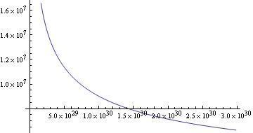

The best white dwarf mass-radius relation that I have numerically integrated is:
[tex]R_{\ast} = \frac{(9 \pi)^{2/3} \hbar^2}{8 G m_e m_p^{5/3} M_{\ast}^{1/3}} \; \; \; \; \; \; \mu_e = 2[/tex]
The white dwarf mass-radius relation equation solution that I derived is:
[tex]\boxed{R_{\ast} = \left( \frac{3}{2} \right)^{4/3} \frac{\pi^{2/3} \hbar^2}{G m_e (\mu_e m_p)^{5/3} M_{\ast}^{1/3}}}[/tex]
Reference:
http://farside.ph.utexas.edu/teaching/sm1/lectures/node87.html"
